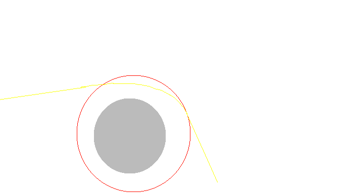

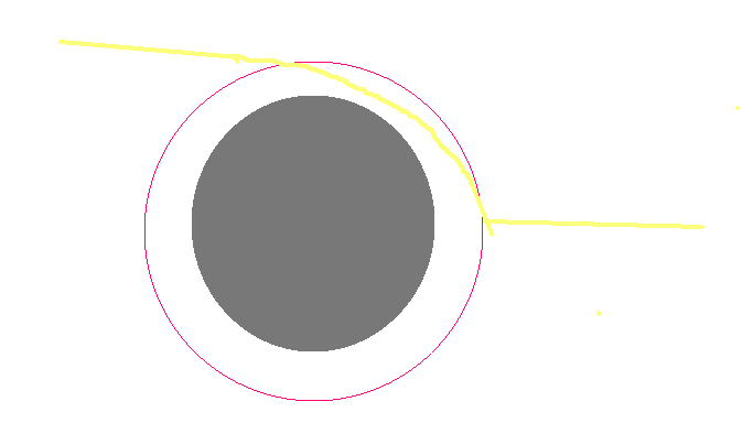

I am asking this question because I dint find a source that explain why the light go in straits line Let say that a light go near very big mass that bend it ,and then the light escape it . would the light change his angle after it band like that
the red part is the range where the mass effect the light .
or weather the light continue in the same angle

What would a high-speed particle do?
Likes danielhaish
so you are saying that the light would change is angle after escaping like in the first image
Gravitational fields have infinite reach, so there's no radius where light isn't affected by gravity.
However, the effect decreases with distance. Qualitatively, the orbit of light isn't very different from other "open" orbits like the blue trajectory in this image from Wikipedia. The exact trajectory isn't quite that shape, but it does become less and less curved the further from the mass it is. It's never exactly straight, but it definitely never has the funny kinks in it that you've drawn in your second diagram.
What does "change its angle" mean? Your second diagram wouldn't make any physical sense for a comet, say.
The path of a light ray is effectively a limiting case for the paths of particles with mass.
Likes Ibix and danielhaish

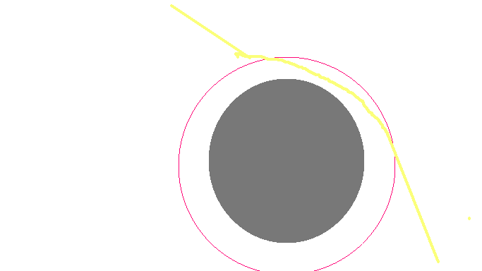

Note that, in general, paths taken by light and particles are reversible. Looking at that might be a light ray entering from the left and exiting on the right or vice versa.
Now, if light came in from the right, why would it follow your path?
Whereas, this path makes sense in reverse:

danielhaish said:
because that if the light is not effected by gravity and going through the space straits then when the space will change the light would change back, but if the light effected by gravity because it photon have mass of hv/(c^2) then the direction of the light wouldn't come back to be straits
That makes no sense. In particular, beyond anything else, a photon or particle has no kinematic memory of a direction it was going in at some earlier time.
The diagram above, with the sudden change of direction, makes absolutely no physical sense.

I believe the question of the OP is equivalent to: "Does placing a (distant) massive object near the sightline of a (further distant) star change its angular position in our sky?"
The answer is yes and so the second drawing is incorrect. The first drawing should be symmetric but is the more accurate.
