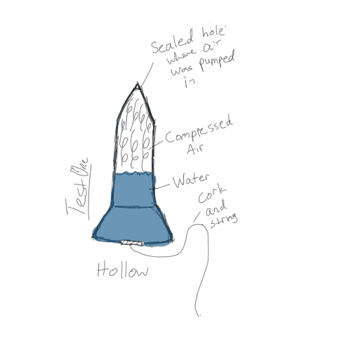

I've never had an interest in rockets, or pretty much anything physics/science related until I took a physics course over the summer, and ever since then I've hardly stopped thinking about it. The question I have is, can you build a wooden rocket that uses water and compressed air to fuel it, if only temporarily?
Here is a rough outline of what I hope to accomplish, if its even at all possible
Basically what I want to do is carve/hollow out a piece of wood into this basic shape, and note: the line at the bottom was just so that I would get the shape right, and will not be there in the final design.
After I carved/hollowed it out, I would carve an appropriate sized hole in the bottom, fill it with water to a certain point, and then put a cork with a string attached to it, at and seal it up airtight. Then at the top of the rocket, I planned to get a basketball pump, the ones with the long thin needles, and basically make a tiny whole in it, put some putty like substance in it (so that the air does not pass through the whole) and after I had pumped all I could, I would cover It up quickly with the putty, and then attach the top part again, with something like gorilla glue.
But upon thinking about it, It might be easier to just pump the air through the bottom of the cork, and then just sealing that up if that would work. Then for the launch process, i would put it up on a raised height, and basically pull the cork out, letting the compressed air out and shooting the rocket up at least a little bit.
I've never been a wiz at science, and just wondered if anyone on here would know if my idea would work, or if it had any flaws that could prevent it from working? And also since air will always try to rise to the top of the water, I thought that it wouldn't matter if the water was on the bottom of the rocket, and the compressed air was at the top, or does it have to be the other way around?
Sorry for such a long post. :D
That could certainly work. Home-made water rockets are a great way to learn various principles of physics, engineering, aerodynamics and workshop skills. There are no major flaws with your design; water at the bottom of the rocket will be just fine; since the pressurised air above will force the water out of the bottom anyway. It'd be pretty difficult to keep the water at the top, anyway!
My main modification to your idea would be to just have one hole (where the cork is) to introduce the compressed air. That way, you don't have to worry as much about sealing your chamber; and as you say, air will rise above the water anyway.
Other things to think about:
- How about making the rocket out of an old fizzy drinks bottle? These are ideal for home-made water rockets, since they are purposely designed to hold water at pressure. (A 2 litre Coke bottle will hold at least 10 bar, but be careful if you use such high pressures!). As a bonus, the rocket will be much lighter, and easily replacable if you lose/burst it.
- How about designing a 'launch pad' to hold the rocket down while you fill it with air. This would allow you to get much higher pressures, since the cork will not pop off until you're ready for blast-off.
- What about experimenting with different styles of fins?
- What about experimenting with different amounts of water in the bottle?
Finally, although you're only messing with air and water, be careful! As I mentioned, Coke bottles will easily take 10 bar, and a well-designed rocket at this pressure will easily cause you some injury if you get in its way.

Thanks, and yes I've seen the 2-liter water rockets before, and I've even seen them explode, so I just wanted to make it more compact/agile, and my main concern is making the wood thin enough to go up, but strong enough to withstand the pressure.
You can save yourself a lot of carving by choosing the right wood. Remember, the very first rockets centuries ago in China were made of bamboo. It's already hollow, except for the septums that are easy to remove, and is very strong.

Vandorin, please reconsider your idea of making a chemical rocket. With respect, you clearly haven't got much of a clue with regard to basic physical principles, and experimenting with combustibles with a little knowledge is a very quick way to end up maimed, blind, or dead.
Stick to your bike pump bottle rocket idea; it's much safer and the results will still be impressive.
