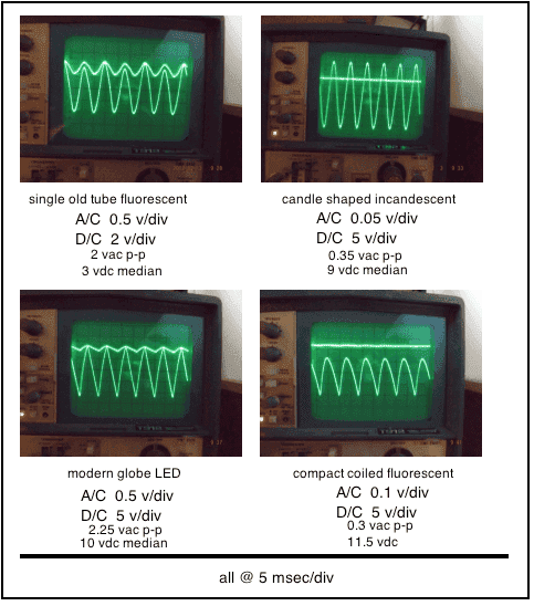

There is a measurable 120 Hz flicker in US incandescent lighting, a stronger flicker at the same rate in fluorescent illumination, and a maximal on-off flicker in AC-driven LED light. However, the cyclic variation of brightness is too fast for most people to perceive without a device to count the on/off cycles.

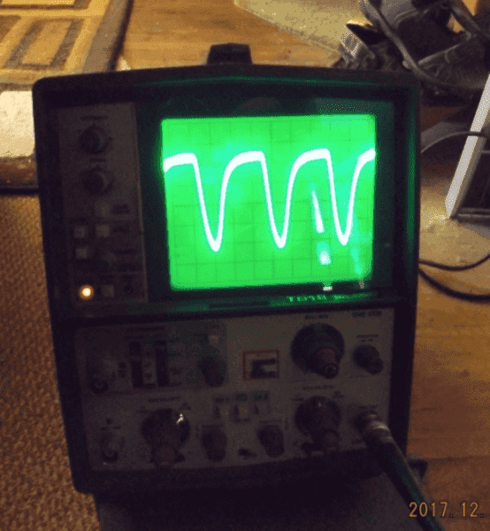

The worst case flicker I've seen are half-wave LED Christmas lights, which just use a diode to only allow half of each AC cycle to power the LED's.
Currently doing a test, as I think I have one of these sets of lights:
@dlgoff , did I do this right?
Looks good to me.
Is the display showing zero volts at the top (and I assume negative voltage "spikes")? I would expect a bit over half of the time spent at zero volts on a half wave LED lights. Each LED has a small circuit, and there may be some type of capacitor to help a bit. I have both half wave and full wave LED lights, and the difference is very visible.

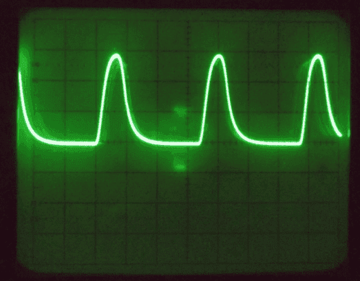

Actually, it's upside-down. I did tests on several lamps, and I've completely forgotten how to use an o-scope. (It's been 30 years!) I ended up reversing the leads in an attempt to make sense of what was going on.
Anyways, it was set to "AC", and I'm measuring the light output with a solar panel, so it "floated" down.
With the o-scope set to "DC", and the probe connections corrected, it looks like this:
None of the other lamps I tested bottomed out at zero volts. Though, they had interesting "noise" patterns, which I can't visually perceive.

The "flicker " in AC bulbs is extremely difficult to detect visually since the difference between maximum and minimum is only a few percent.
As for fluorescents, if they use a magnetic ballast then you have flicker (0-100% difference) at twice the mains frequency (100Hz in Europe, 120Hz in US). If its a newer fluorescent then it should have an electronic ballast and the flicker frequency is going to be 20-40kHz. Good luck trying to see that.
As for LEDs, the frequency can vary. Most decent LED lamps will use a switching power supply which pushes the major artifacts into few hundred to few thousand Hz range. The filament style bulbs are the worst and will be as bad as magnetic ballasted fluorescents. Even a small capacitor though can improve the perception. Go for a cheap LED bulb/fixture and you will get exactly what you pay for.

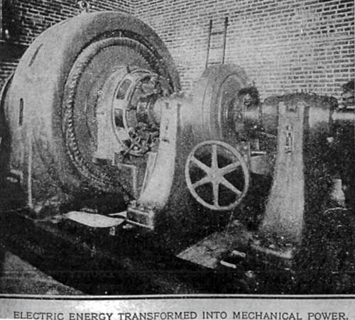

I recall that 25 Hz at Niagara Falls continued until the 1990s. But not for lighting, but rather to power motors in the local mills. The motors were so rugged, that they needed no maintenance since 1895 other than a few drops of oil. There was no motivation to replace them with modern motors
Now that is some impressive design! To last almost a century without much maintenance is really amazing. If the original 25 Hz were no longer available, they would have had to scrap these great motors, or at the very least, do a major rebuild. Do you know what kind of mills they were powering (textiles, steel, feed, ?)?
I think it was textiles and flour mills. I used to have pictures of them but I can't find them. However, a 3 HP motor in 1895 was about 10 feet tall.
