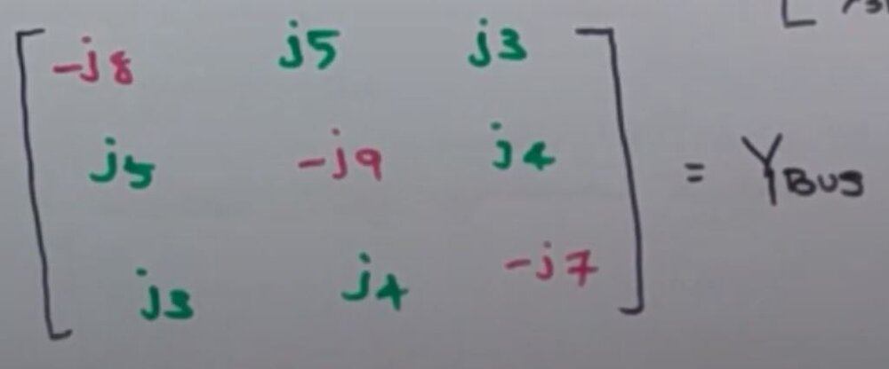

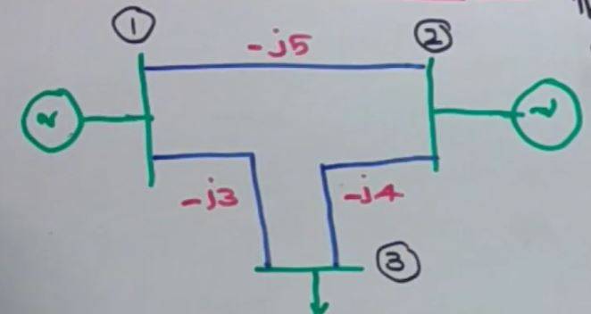

Write MATLAB code to find Y bus for any bus system, calculate Z, I, Bus voltages, and power of the following system (attached below).
Here's my work:
Matlab:
clc;
clear all;
% Ybus by step by step method for an any bus system
%         |  From |  To   |   R     |   X    |   gsh    |     B  |   T|ysh
%         |  Bus  | Bus   |  pu     |  pu    |    pu    |     pu   | ph-sh
linedata =  [1       2        0        -5         0          0        0
             1       3        0        -3         0          0        0
             2       3        0        -4         0          0        0];
fbus=linedata(:,1);             % Reading from bus
tbus=linedata(:,2);             % Reading to bus
R = linedata(:,3);              % Resistance, R...
X = linedata(:,4);              % Reactance, X...
gsh=linedata(:,5);
B = 1i*linedata(:,6);         % Ground Admittance, TOTAL..
T=linedata(:,7);
Z= R + 1i*X;                    % Z matrix...
y = 1./Z
buses = max(max(fbus),max(tbus));      % No. of buses...
lines = length(fbus);               % No. of elements...
%        Eg    Xg  Zd
BusData=[1     1   inf
        0      0   inf
        0      0   inf]
Eg=BusData(:,1);
Xg=1i*BusData(:,2);
Zd=1i*BusData(:,3);
Zd=-1./Zd;
Xg=-Xg;
ybus= zeros(buses,buses);       % Initializing YBUS as a zero matrix
for i=1:lines                % Forming the off diagonal elements
 if fbus(i)>0 && tbus(i)>0
     ybus(fbus(i),tbus(i))=ybus(fbus(i),tbus(i))-y(i);
    ybus(tbus(i),fbus(i))=ybus(fbus(i),tbus(i));     %same as opposite element
 end
endfor i=1:buses                   % Forming the diagonal elements
    for j=1:lines
        if fbus(j)==i || tbus(j)==i      % || represents  OR
            ysh(i,i)=(gsh(j)+B(j))/2;
            ybus(i,i)=ybus(i,i)+y(j);
        end
    end
end
yn=ybus+ysh+Xg+Zd   %Y
I=[Eg/Xg]           %I
Z=inv(yn)           % Z
V=inv(yn)*I         %Bus voltages
However, I got a different result from the corrected one (attached below). Could someone figure out my mistake please ?
