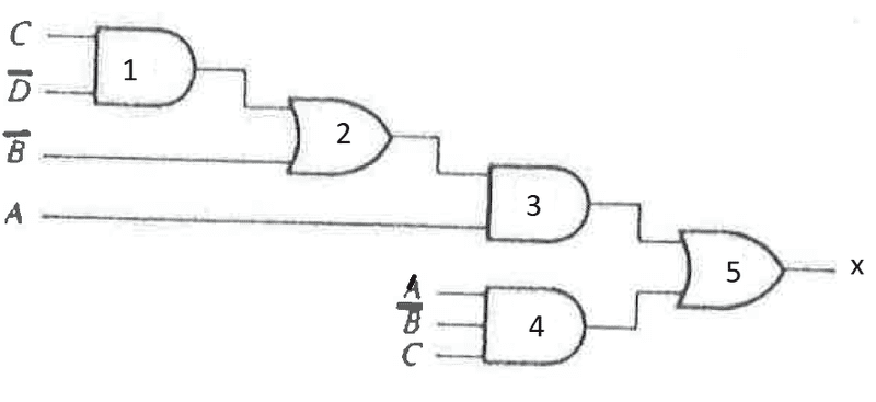

In the logic circuit shown below , write the Boolean expression for the output function X . Which gate(s) could be removed without affecting the function X ?
[/B]
So , we can get rid of ##A \overline{B} C ## . gate # 4. Right ?
Right!
Likes Fatima Hasan
Why not also get rid of gate #5?
Likes Fatima Hasan
