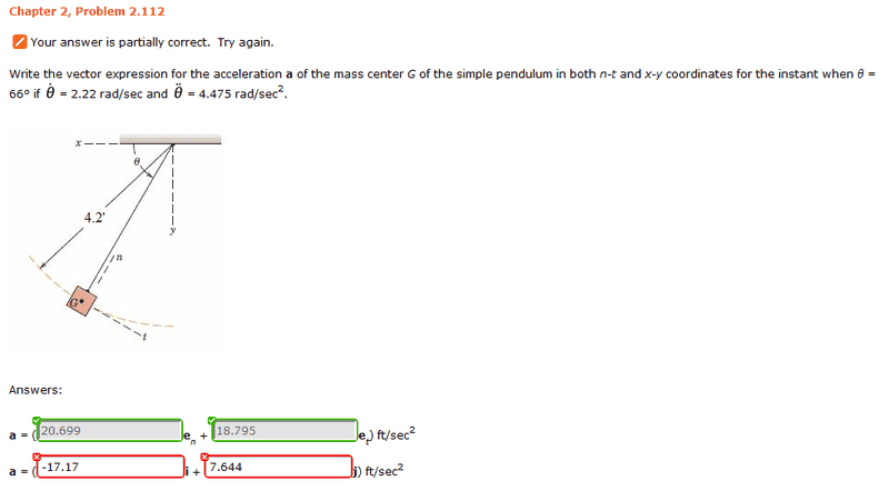

Write the vector expression for the acceleration a of the mass center G of the simple pendulum in both n-t and x-y coordinates for the instant when θ = 66° if θ'= 2.22 rad/sec and θ"= 4.475 rad/sec2
I have attached an image of the question.
an = v2/r = rθ2 = vθ'
at = v' = rθ'
I've managed to calculate en and et correctly
at = (4.2 ft)(4.475 rad/sec2) = 18.795 ft/sec2
at = 18.795ft/sec2
For an I calculated velocity first:
v = rθ' = (4.2ft)(2.22 rad/sec)
v = 9.324 ft/sec
Hence an = (9.324 ft/sec)(2.22 rad/sec)
an = 20.69928 ft/sec2
Unfortunately, I'm now having difficulty with finding the velocity in terms of i and j.
I had thought that I could use geometry to do it:
atcos(90-66) = -17.77 i
atsin(90-66) = 7.644 j
But the system says it's wrong. Help is greatly appreciated.

Why don't you try to express en and et in terms of ex and ey ? Doing that, you can find the total acceleration, a = an + an , in terms of its projections on x and y axis.* e i is the unit vector in the direction of the subscript "i".

Both n and t components contribute to each of the i and j components.
@SammyS: You were right. To find the i component I did the following:
-atcos(24) -ancos(66) = -25.589i
For j:
atsin(24) - ansin(66) = -11.265 j
