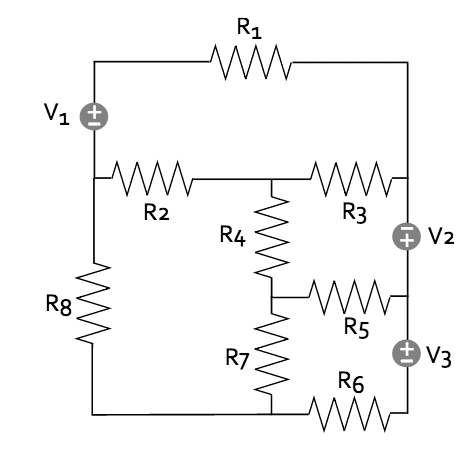

I need to write Kirchhoff rues for the following circuit. This is not for a physics class, but for a programming class. I can do that part, but I am not sure if the equations are correct.
V1-I1*R1-(I1-I2)R3-I1*R2=0
V2-(I2-I3)R5-I2*R4-(I2-I1)R3=0
V3-I3*R6-I3*R7-(I3-I2)R5=0
These neglect R8, however.
Should I also include:
V1-I1*R1-(I1-I2)R3-(I1-I2)R4-(I1-I3)R7-I1*R8=0
V2-(I2-I3)R5-(I2-I3)R7-(I2-I1)R8-(I2-I1)R2-(I2-I1)R3=0
V3-I3*R6-(I1-I3)R8-(I3-I1)R2-(I3-I2)R4-(I3-I2)R5=0
These last three equations seem really wrong. I am not sure how many currents there even are.

Welcome to PF!
For writing KVL, take no of currents= no of meshes (smallest loops). You can see 4 meshes here, so assume four currents.
So they are wrong. Why did you write them?
These equations are also wrong.

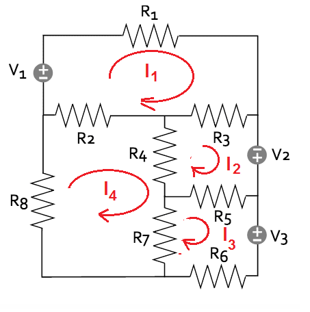

Choose loops and loop currents and draw the currents clearly. Note that you have 4 independent loops, so you need to write 4 loop equations.
This is a possible arrangement:
Likes CWatters
So these are the new equations that I came up with, but something still is not quite right:
V1-I1*R1-(I1-I2)*R3-(I1-I4)*R2=0
V2-(I2-I3)*R5-(I2-I4)*R4-(I2-I1)*R3=0
V3-(I3-I2)*R5-(I3-I4)*R7-I3*R6=0
I4*R8+(I4-I1)*R2+(I4-I2)*R4+(I4-I3)*R7=0
In your third equation you ignored the defined current direction of I3. You did your "KVL walk" around the loop counterclockwise, which is fine, but you wrote the equations as though you were going in the direction if I3 rather than against it. For example, I3 should cause a potential rise as you pass through R5.
Once you've defined the direction of a current and used it in other equations you must stick to what you've defined.
