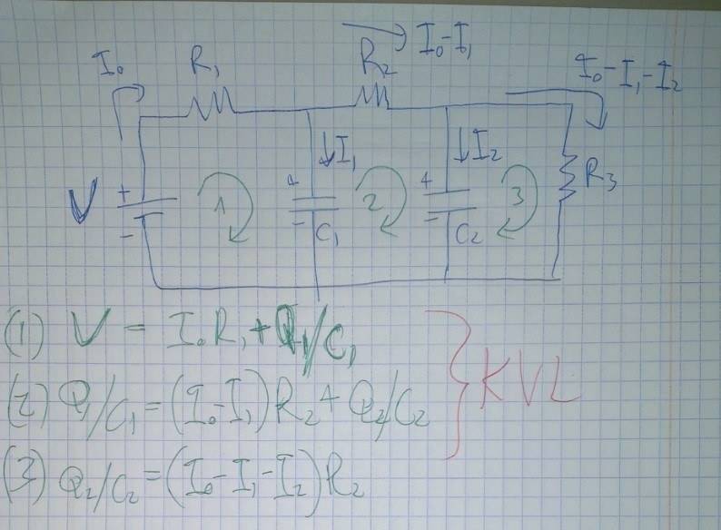

Given the circuit in the picture, I need to:
a. write a system of diff. equations that could solve the charges on each cap. and current on each resistor, and write them in a vector/matrix form.
b. solve the equations for t>>τ
Kirchoff's laws, perhaps Thevenin's theorem, although this wasn't my attempt at it.
I wrote the equations for voltage loops.
First was the outer loop, yielding
##V=I_{1}R_{1}+I_{2}R_{2}+I_{3}R_{3}=I_{1}R_{1}+\frac{1}{2}I_{1}R_{2}+\frac{1}{4}I_{1}R_{3}=R_{1}\dot{Q_{1}}+R_{2}\dot{Q_{2}}+I_{3}R_{3}##
Second was
##V=R_{1}\dot{Q_{1}}+R_{2}\dot{Q_{2}}+Q_{2}/C_{2}##
Third was
##V=R_{1}\dot{Q}_{1}+Q_{1}/C_{1}+Q_{2}/C_{2}##
And lastly, although obviously one of these is redundant, the loop containing both capacitors yields
##I_{2}R_{2}=R_{2}\dot{Q}_{2}=Q_{2}/C_{2}-Q_{1}/C_{1}\Rightarrow Q_{2}/C_{2}=Q_{1}/C_{1}+R_{2}\dot{Q_{2}}##
I think I'm supposed to have enough info here to be able to write a decent set of diff. equations, but somehow meshing the equations together didn't result in anything. I mean, first I'm not sure if the equations are indeed enough for a theoretical solution, and second I'm a little puzzled at how to transform all of this into vector form.
Any leads?
Thanks!

I don't think that your equations are correct. They look like Kirchhoffs voltage law, but I don't understand what you are doing. How come that I2 = ½*I1 and that I3 = 1/4*I1?
You must read Kirchhoffs voltage law, and sketch the current loops that you use as for I1, I2, I3.
Edit: I assume that you switch on the battery at t = 0 ?
OH Yes!
You're right.. my thinking was that the currents are additive, and therefore split at the junctions, but of course they don't necessarily split evenly...
Ok, I'll have another go at it.
Thanks

Try to write equations for ##\dot{V}## to use Kirchhoff's laws. With ##\dot{Q}## the voltage expression is not clear.
Hmm.. but the voltage I think is given as a constant
When use 2nd law we right the current for the whole hang and express the i.e. ##I_{c1}## as ##I_1-I_2##. With this notation relations for current can written as:
$$ I_1 = \frac{V_0-Q_1/C_1}{R_1} ,\, I_2 = \frac{Q_1/C_1-Q_2/C_2}{R_2} ,\, I_3 = \frac{Q_2/C_2}{R_3} $$
I think this notation makes easier equations.

From what I've learned, I can notate the currents on a circuit like in the following figure (and I could also add bigger loop eqs., but they cancel out eventually)
Those equations look good. Now solve for ##I_0##, ##I_1##, and ##I_2## in terms of V, Q1, and Q2.
Likes Yoni V
#11: You are mixing physical currents and loop-currents.
The green arrows are not just paths. They are loop-currents. Call them m1, m2, m3. I0, I1, I2 are physical currents, you can measure them. Z1 = 1/sC1 and so on.
Here it goes:
(m1): V - m1*R1 - 1/(sC1)*(m1-m2) = 0
(m2): 1/(sC1)*(m1-m2) - m2*R2 + 1/(sC2)*(m3-m2) = 0
(m3): Try it yourself
Solve m1, m2, m3, then:
I0 = m1
I1 = m1 - m2
I2 = m2 - m3
Likes Yoni V
