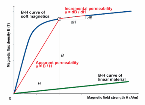

The answer key seems a mess to me. Somebody didn't pay attention to his basics.If we allow for the non-linearity of B-H curve, ie include effects of saturation, then inductance and reactance both will increase when you lower the voltage.
Remember - inductance is flux linkages per amp, NΦ/I ,
and at lower flux it takes less current to magnetize the iron because you are farther away from the knee where saturation becomes an issue.
so since I is in the denominator not the numerator i'd say their reasoning is inverted.

jim hardy said:
But C is still the right answer.
If we include saturation effects in the inductor model won't rotor leakage reactance also be affected? So the answer should be B and C? I'm actually rusty on this topic so I'm not confident that it would be but since the circuit is linear it's hard for me to see how they're not both "affected", which is all the question requires.
eq1 said:
This assumes constant output power from the motor though right?
i don't think so, at least i didnt assume that. It should be true for any stationary iron core inductor.
I don't disagree with your physics , because
as flux density approaches saturation the fraction of it that gets squeezed out into the air changes as well.
But i don't wholeheartedly agree with B because in the context of that test question i think the author didnt go that deep. It's a smaller effect that also depends on slip.

Answer is C. The magnetizing reactance is L*omega. But L = N*phi/I. Phi decreases with decreasing supply voltage, as does magnetizing current I. But as Jim said, when supply voltage decreases, L increases, moving away from saturation.
Only C can be correct. As far as leakage reactance goes, the path for leakage flux is air. Not affected by how close or far from saturation.
