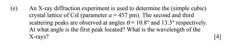

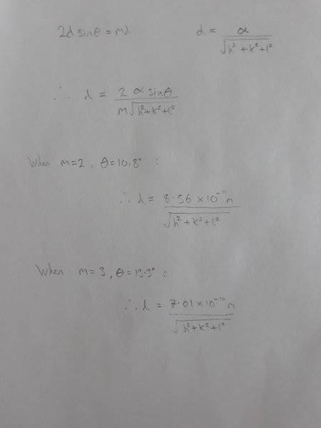

Hi All,
I have two issues with this question. First of all when I put the given values into the Bragg condition for diffraction I get two different wavelengths when the question implies there is only one. Secondly, I don't know how I can calculate the lattice plane spacing, d, from the given information. Any help would be appreciated, thanks!

The correct formula is:
λ = 2 dhkl sinθhkl
In case of a cubic lattice with lattice parameter a one has :
dhkl = a / sqr(h2 + k2 + l2)
You have now to find out what (h k l ) planes give rise to the second and what (h k l ) planes give rise to the third scattering peak in the X-ray diffractogramm of CsI.

I have no idea how to work that out from the given information...in lectures we were shown how to calculate d when the lattice plane was known
There is no "m" in the equation λ = 2 dhkl sinθhkl. Do you understand that the scattering peaks which are observed at 10.8° and 13.3° are due to scattering from different planes with different Miller indices. This has nothing to do with mth-order reflections.
