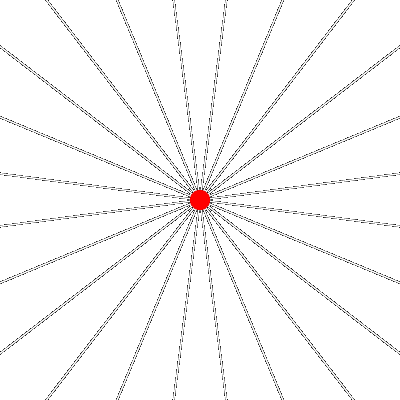

If found a nice animation on this here:
http://www.tapir.caltech.edu/~teviet/Waves/empulse.html
This is what happens with the E-field when an electron suddenly starts moving, with short period of large acceleration. As you see high frequency (short wave length) radiation goes mostly perpendicular to the direction of acceleration.
In the X-ray tube the acceleration by the field is negligible compared to the acceleration on anode impact. So the animation above shows approximately what happens in the initial rest frame of the electron during anode impact (anode comes from the right and hits the electron). In reality, due to the acceleration by the field, the lines would be slightly bend initially. But the X-ray is the sharp distortion of the filed lines, emitted on impact.
