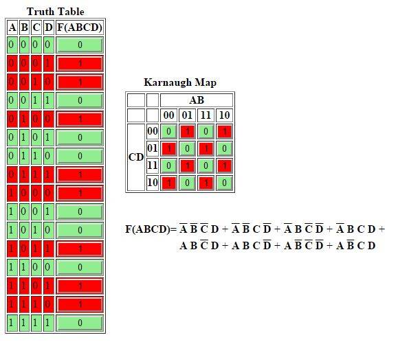

Z(A,B,C,D) = SUM-M(1,2,4,7,8,11,13,14)
Draw circuit of Z with lowest number of 2 inputs xor-gates.
Can i have a clue? I tried drawing k map and had too many terms.

So from the K map, in the 1st row, AB looks like a xor.

Your observation about the first row of the map is good. Note how the third row is identical. Note also how the other rows are the negation of them. Contemplate how you might build a NOT gate from an XOR. Does it give you any ideas?

Ok so With a xor gate i can get a'b+ ab' as an output. Let's call this output as P.
Next step is for me to get c'd' + cd which is simply xnor? So i will use a xor(c,d)=Q. Th3n ill xor(Q,1) to get the inverse?

It's getting complicated again. If I may suggest a short digression:
Did you spend any time playing with the XOR gate to try to make a NOT gate? Hint: you can assume access to constants TRUE and FALSE (or 1 and 0) to use as inputs anywhere you like. If you feed one input of an XOR with a fixed 0, what does it do to the other input? How about if you use a fixed 1? Can you think of any interesting uses for such a beast? How about if the "fixed" input were actually another signal?

Okay, but maybe you can think of another signal to use for the "1" that would select the appropriate action for that XOR to match the other rows in the table? What values of cd are associated with the "straight" a XOR b, and which with its complement?

Hi my finam answeer
answer.
Q = XOR(A , B)
P = XOR(C , D)
ANS = XOR(Q , P)

That seems to work.

Yes, well done.
