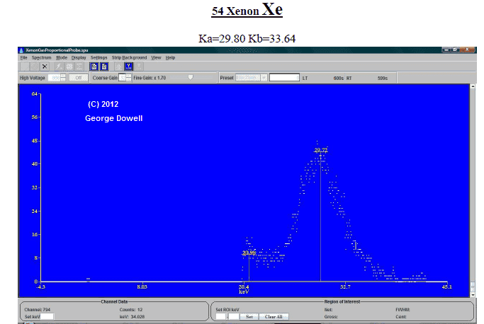

You asked: "Also - let's assume the incident X-ray was (purely for illustration) 30 keV. By chance, this is the K-shell binding energy and the electron is ejected, and a Kα1 emission results. So, you have 30 keV absorbed and 30 keV emittied, "
Answer: Generally the exciting energy in the form of X-Ray, electrons, alpha particles etc., to make an element XRF is chosen to be at least just above that element's K-edge, although any energy above that will work too. This energy level may be found using a K-edge calculator such as:
http://www.csrri.iit.edu/mucal.html
Here are the X-Ray statistics for Xenon (Ka=pretty close you your 30 keV hypothetical) - notice the fluorescent yield probabilities (heavily weighted towards K shell):
X-ray properties
Data for Xe; Z = 54
atomic weight = 131.300003 ; density = 5.90000022E-03
K-edge at: 34.5820007 keV
L-edges at: 5.45200014 , 5.09999990 , 4.78100014 keV
M-edge at: 1.14300001 keV
K-Alpha1,K-Beta1 at: 29.8020000 33.6440010 keV
L-Alpha1,L-Beta1 at: 4.11100006 4.42199993 keV
K,L1,L2,L3 jumps: 6.07753229 1.15944588 1.40999997 2.87899995
Fluorescence yield for K,L1,L2,L3: 0.8910, 0.0460, 0.0830, 0.0850
and from the XRF Periodic Table of the Elements:
Xe K and L shell Binding E
So somewhere above 35 keV or so. In practical terms what this means is if you have a choice of X-Ray tubes with targets of Cu, Mo, or W, you would select W based upon it's "Characteristic X-Ray" peak, with appropriate low energy filters.
