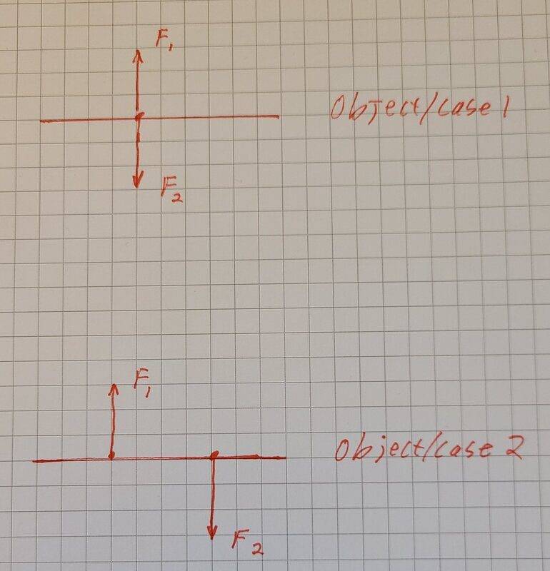

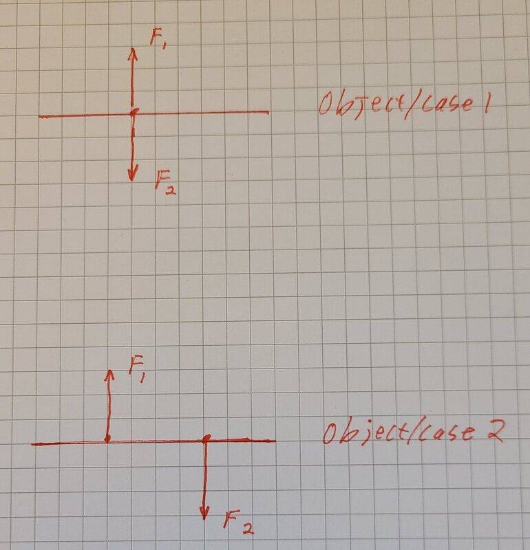

One of these objects rotates and the other doesn't. Which is which, and why? Note, the question does not contain the words "axis of rotation" or "center of gravity" and your answer shouldn't either.
russ_watters said:
To be frank, what I see in many of your posts/threads looks more like a stubbornness/lack of desire to learn than lack of ability to learn(among other issues). In order to learn, you first have to accept that what you currently believe is wrong, and you don't seem to want to do that. This particular issue is simple enough that pretty much anyone who can write a complete sentence should be able to understand it:
Object 2 rotate.
If F1 and F2 is equal magnitude,this is pure rotation about half the distance between two forces,zero translation.

John Mcrain said:
Object 2 rotate.
Correct!
It isn't known if F1 and F2 are equal. You didn't explain why and you are bringing in axis of rotation when I explicitly told you not to. Explain why it rotates, and don't discuss axis of rotation.

John Mcrain said:
Object 2 rotate because forces are not lie at same line...
Close enough. The way I would word the answer it is that the object rotates because there is a net torque. Next question:
About which point(s) does the object rotate? Use the previous answer in your response to this one.
(Now you can assume F1 and F2 are equal/opposite.)

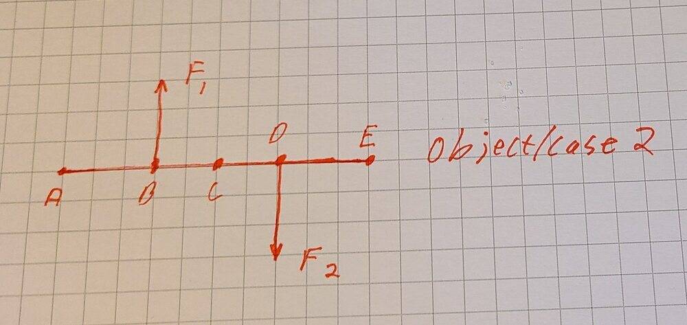

I say about point C if F1 and F2 is equal in magnitude...
But you say about any point...
The correct answer is any point because of the prior answer: it rotates because there is a net torque. So, let's prove it.
The distance between points is 1. What is the net torque about point C? How about point A?
F1=F2=30
point C
MC= F1x2 + F2x2 = 30x2 + 30x2= 120
point A
MA=-F1x3 + F2x7 = -30x3 + 30x7 = 120
John Mcrain said:
F1=F2=30
point C
point A
You didn't need to assign a value to F and you used the wrong distance, but anyway, you got the same answer for each. There's a net torque about each point and it's the same torque.

John Mcrain said:
What wrong distance I made?
Each interval is 1 unit of distance, so the torque about C is -1F + (-1F) = -2F (clockwise, by defining up and right as positive)
I count each square 1 unit..
I told you what the distances were...
