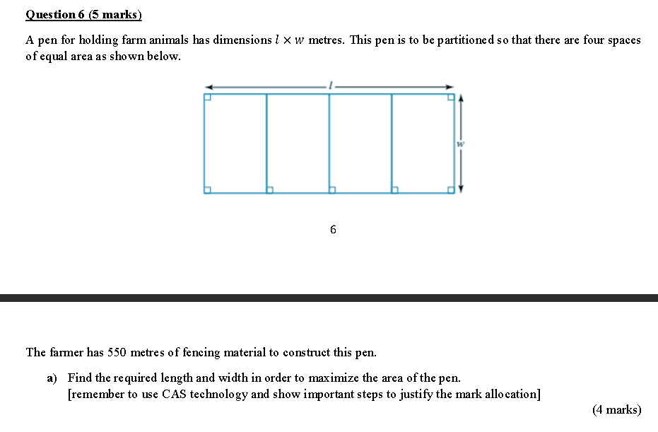

The question is in the image. Working out with every step would be much appreciated.

Here's a start:
Let $W$ be width, $L$ be length an $A$ be the desired area. Then,
\(\displaystyle 5W+2L=550\)
\(\displaystyle LW=A\)
Can you make any progress from there?
Greg said:
Here's a start:
\(\displaystyle W=\frac AL\)
\(\displaystyle \frac{5A}{L}+2L=550\)
\(\displaystyle 5A+2L^2=550L\)
\(\displaystyle A=110L-\frac{2L^2}{5}\)
$A$ has a maximum at the vertex of this inverted parabola, so $L=\frac{275}{2}$. Finding $A$ and $W$ from here should be straightforward.
