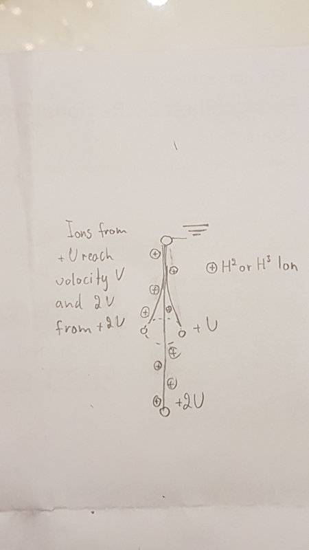

I wonder if you can do the same thing (as sheared flow stabilezed-Z pinch by W.U) with different potential, namely different speed along the radii, se attached pic. That would be even simplier and maybe the pinch can be constant more or less.
Sorry for last confusing replay. I had to make a change a thing and couldn't take it back.
As I begun last time I wonder if you can do the same thing (as sheared flow stabilezed-Z pinch by W.U) with different potential, namely different speed along the radii, se attached pic. The idea is that ions that travel from potential +2U has higher speed then ions from potential +U. And thereby you can achieve a stable pinch more or less constant. The electric field is the same for the ions, but not the speed at the end.
