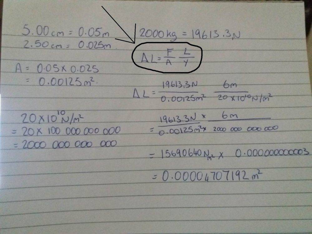

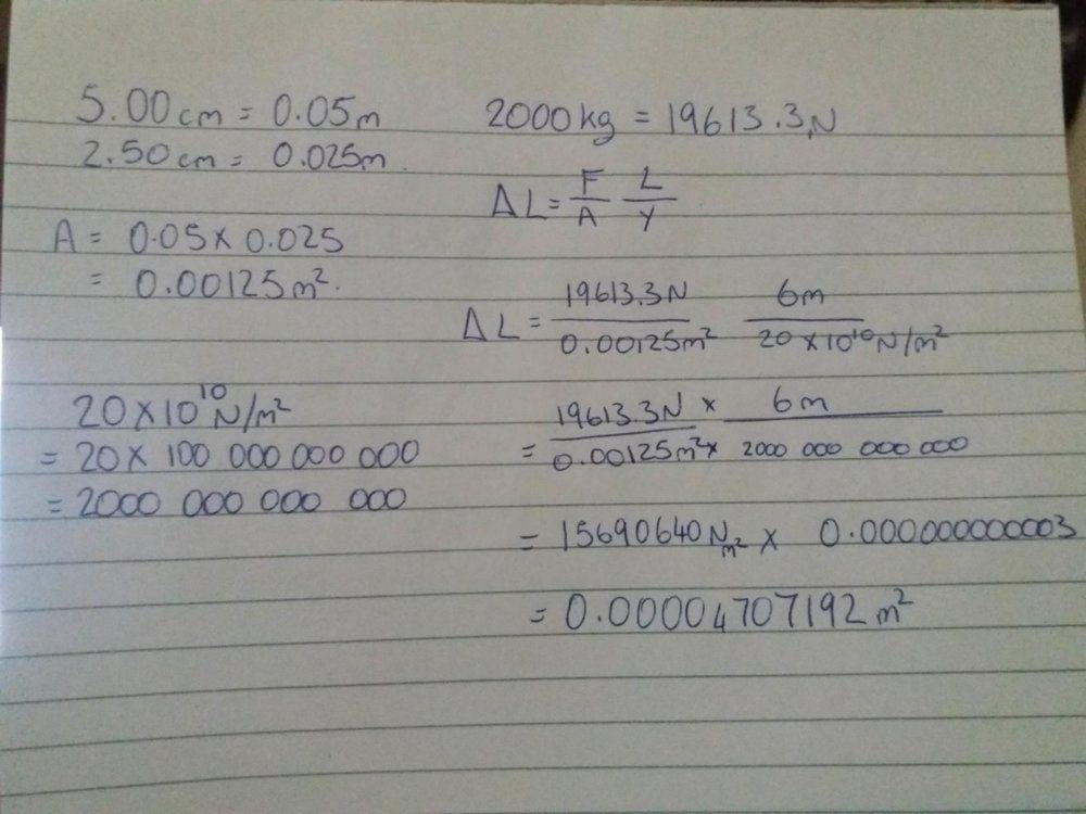

so this is how I did it and I m sure it s wrong

That Young's modulus value you give for steel is not right.
What is the equation for the force in terms of Young's modulus, the length of the bar, the change in length of the bar, and the cross sectional area?
Yeah that s my problem, the value of the young s modulus . the 20 x 10 have to be to the power of 10 but I can t type that right ?

My problem is how to work out the original length over the young modulus.

Closer, but written that way it is highly ambiguous. Please write it as an algebraic expression, using the variables I defined, and with proper use of parentheses.
It s that formula there , could be that it s called also an equation .
Yes, that's the expression. Sorry, I hadn't looked at your post #4 before, I was only explaining the question in post #5.
Most of your work looks ok to me, and the value for Young's modulus of steel is near enough, but you seem have lost count of the leading zeroes somewhere. Instead of writing those long strings of zeroes use exponents, 10n.
And there's no point in keeping so many significant figures. Given your modulus value only has two sig figs you can truncate the weight at 20kN, etc.

So the value Y in that equation is my problem , how do you have to put it in the calculator ?
by the way , the value for the young s modulus is given in the question .

Are you asking how you put powers of 10 into a calculator? That depends on the calculator. They usually have a 'scientific' mode. Otherwise, plug all the values in as just one digit before the decimal point and keep track separately of your powers of 10.
(That's what I did in my head when I checked your arithmetic. I did not need a calculator.)

ok so that I wrote 2000 kn in the calculator was good , I will work to find where I have a mistake in the answer.or maybe you will work it also for yourself.
thanks for now you was helpful .
Eh? No, 20kN, or 20000N.
Oh sorry yes 20000 can t do the N
Although the number is 2000 000 000 000 on my paper that I marked for you.
