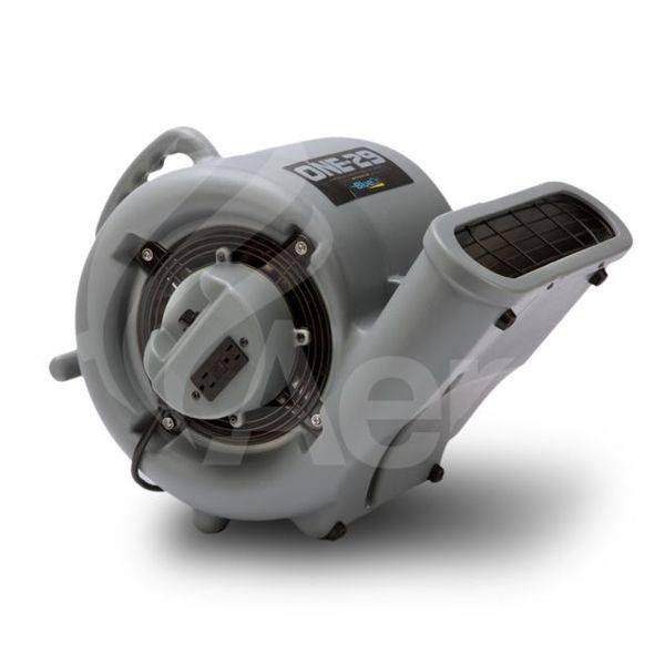

okay, so I'm working on a prototype for a hover bike. The end design will have a 600cc engine and hopefully impressive stats. Currently I'm working with a 49.5cc moped engine. The skirt design is pretty straigt forward as is the thrust and steering.
I'm having some trouble determining what type of fan I can use and how big of a fan I will need.
I'm hoping to use a fan similar to a floor blower. I don't know the name of this type of fan but I'm going to call it a "scoop fan" until someone corrects me.
The idea is to use a single fan to create lift and thrust. The "scoop fan" will be mounted in the rear like the back tire of a motorcycle. This will then be boxed in and vented to direct air flow through two openings, one down into the skirt and frame to create lift and the other out of the rear of the craft for propulsion and steering. (I realize this may not be enough power to accomplish both and that's something I'm willing to work with in a later design. Currently I'm concerned with lift and stability.)
Any comments or suggestions are welcome. Especially if you know where I can find fan blades that fit the description above. (Not something I'd like to have to fabricate)
Thanks all.

Think of how a bike tire is mounted to the frame. I'm tryihg to use a fan that is mounted like that chain driven, exactly like a bike tire. The design on those in the videos is using prop fans and aiming them downward to create lift. The lift on my design will come from the skirt and If I'm lucky enough to have the extra power the thrust will come from a vent on the same fan in a different direction.
The image below shows, roughly the "type" of fan I need. Granted, i just need a larger version of the blade in this fan, not the entire unit.
A prop fan works like a ceiling fan and blows air from the face. These little guys throw air sideways off the tips of the blades. The two main differences I've noticed are the angle of the blades and the housing around them.
My thought is take a larger version of the blad in this carpet dryer fan and have two vents instead of one. The primary vent will feed the air skirt and provide lift and the smaller secondary vent will run out of the rear and hit a rudder for steering.

Have you done any basic calculations on this? I could imagine the required skirt size to keep you from toppling either side to be prohibitively large.
There are calculators online, but you don't really need them: lifting force is pressure times area. For airflow, use Bernoulli's equation to find the velocity and multiply the skirt perimeter by how high off the ground you want it.
I'm not sure what "prohibitively large" is, but I think hovercraft are self leveling.
Hovercrafts are, but hovercrafts are also intentionally spreading their load evenly across the skirt, and as low to the ground as possible. OP's idea is a very different setup (if I understand it correctly), where the center of mass is reasonably high off the ground, and solely on one line. That will create a good amount of torque on the skirt, making it all the much harder.
