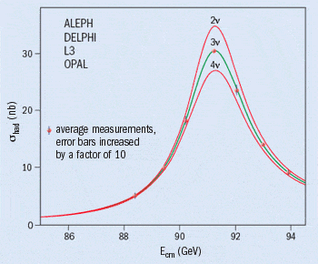

However, tuning the center-of-mass energy of electron-positron annihilation to the Z mass will indeed produce a whole bunch of them.
from CERN courier
Yevgenia said:
e+ + e- --> Z0 + ??
? = nothing
See plot 1.1 page 15 of Measurements @ Z-pole
Note that pretty much anything that proceeds through the Z also may proceed through the photon (and vice-versa) albeit with usually much different strength for the two channels, depending on available energy.

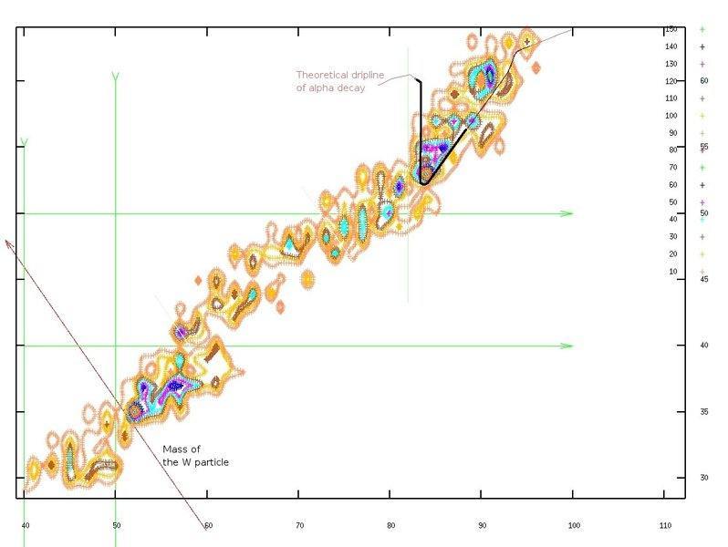

Related to W in nuclei, I had some intriguing plots. here in this thread:
https://www.physicsforums.com/showthread.php?t=227263
About Z, look again at the two dimensional histogram (actually, a contour plot) of
https://www.physicsforums.com/attachment.php?attachmentid=13427&d=1207614889
the attachment. The Z line is painted parallel to the W line, a bit hidden because it seems less relevant. Still, the nuclei with a mass slighy greater than the mass of Z seem to be more stable than usual, or at least no so many beta rays are known, for them.
arivero said:
Related to W in nuclei, I had some intriguing plots. here...
