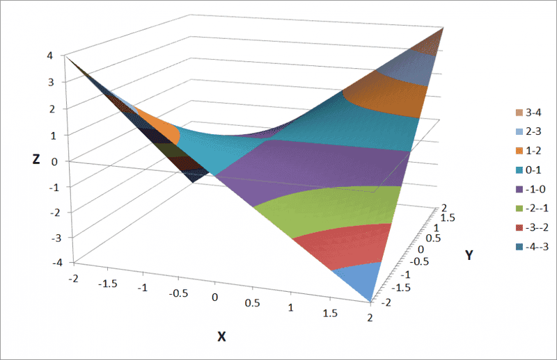

Ok this isn't really homework just something I came across and am confused by. I came across a function that looks similar to z = xy and I found that delta_z / delta_x = dz/dx which is really weird to me. This was really strange to me so I checked to see if z = x²y would also be the same and it wasn't which I expected. I don't know how to explain why z = xy has this sort of property where delta_z / delta_x = dz/dx. Sorry if this is a sort of weird question.
For example let's say z = xy, x = 5, y = 2, z = 10. We increase x to 6 then z = 12.
delta_z / delta_x = dz/dx = y => delta_z = y*delta_x = 2*1 = 2. No idea why this is true though it should be like a linear approximation.
So I was thinking it's true in the same way that for y=mx+b, delta_y/delta_x = dy/dx, now I don't know what to call these type of functions.
Hello jrm, :welcome:
With this function, you can see that if you keep y constant, then z = constant * x, the equation of a straight line.
First, what do you mean by "similar to z= xy"? Was the function z= xy or not? Second, since you are talking about "delta z/delta x" and "dz/dt", what happens to y? If you are treating y as a constant, then z is a linear function of x so of course you get that property. And you call those functions "linear" functions!
Ah so this function is linear? I looked online and it showed linear multivariable functions have the form f(x1,x2,x3,...) = a1x1 + a2x2 + a3x3 + ... So I didn't want to call this type of function linear since it does not have this form. By similar I mean it looks like z = (1+y)(A+Bx). Sorry I made a mistake in my first post. It should have been y = 10, and increases to y = 12, not z. I guess a follow up question would be anything of the form f(x1,x2,x3,...) = x1*x2*x3... would have this behavior if you kept all other variables constant when taking a derivative with respect to one variable and it would be called linear?
Thanks for the responses!
You found the correct criterion for linearity. That doesn't exclude the possibility that the intersection of the 3D graph of your function with any plane y = constant (or, alternativly, x = constant) is a straight line.
Note that for functions of more than one variable we use partial derivatives: Function ##\ z = f(x,y)\ ## has partial derivatives ##\ \partial z\over \partial x\ ## and ##\ \partial z\over \partial y\ ##.
##\ \partial z\over \partial x\ ## is a function of x and y obtained by taking the the usual derivative wrt x while keeping y constant. In your ##z = xy## example ##\ {\partial z\over \partial x} = y\ ##.
And in your z = (1+y)(A+Bx) ##\ {\partial z\over \partial x} = B(1+y)\ ##, which still is a straight line -- hence the ##\ {\Delta z\over \Delta x} = {\partial z\over \partial x}\ ##.
Picture shows intersections with y = -2 is a straight line. So is intersection with x = 2 -- and any plane with x = constant or y = constant.
Ah, that clears things up for me. Thanks!
