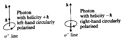

In the picture below ##\sigma^-## line has higher energy than ##\sigma^+##.
I don't see any indication of energy or direction of magnetic field in that picture.
Sorry I forgot to mention that the field is uniform pointing in the positive z direction.
The explanation about the energy is given in the text, there I took the snapshot of the picture only. In the presence of uniform magnetic field the energy level is given by
E = E_n +\mu_B B_z(m_l+2m_s)
The frequency corresponding to down-transition ##n\to n'## is then ##\nu = (E-E')/\hbar = \frac{E_n-E_{n'}}{\hbar} - \frac{\mu_B B_z}{\hbar}(m_{l'}-m_l) = \nu_{nn'} - \frac{\mu_B B_z}{\hbar}\Delta m_l## where ##E>E'## and ##\Delta m_l = m_{l'}-m_l##. The ##\sigma^+## line which is defined to be the transition with ##\Delta m_l = -1## hence has higher frequency than ##\sigma^-## line which is defined by ##\Delta m_l = 1##.
