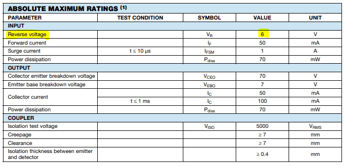

Can the 4N35 optocoupler handle 6 VAC in its input, or do I need to rectify it to DC?

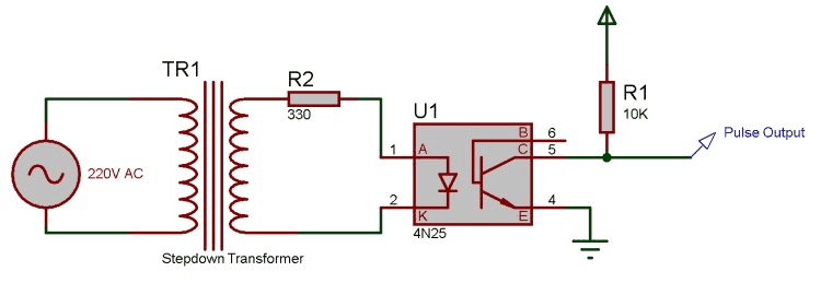

I am designing a zero crossing detector for Arduino using the 4N35 optocoupler. This is just a small part of a large project. I haven't bought the components yet, so do not ask me for readings. Everything is in the planning phase now.
My input will be a 6-0-6 transformer (220V to 6V step down).
I was having a look at this website where they have controlled an AC fan using an Arduino and a TRIAC. They have fed the 9 VAC output from their transformer directly to their 4N25 optocoupler:
In https://forum.allaboutcircuits.com/threads/zero-crossing-with-4n25-issue.138690/, they have first rectified the AC to DC, and then fed it to the optocoupler (don't look at the input; I will be using 6 VAC):
The above circuits use 4N25, but I believe using a 4N35 won't create any problem. Do I need to rectify the input to the 4N35, or can I directly feed it 6 VAC?
Well, 4N24 and 4N35 both are with low reverse voltage for this, I think.
I would keep the transformer only, but put a LED in reverse, parallel with the opto.
Or a different opto, maybe with dual LEDs on the input side (something from here, for example).

As mentioned in response 2, please make sure that the reverse input voltage does not exceed the rated value.
Yes, I will see to that. Maybe I will use a 5V transformer instead of 6V.

Then how do I limit the voltage? (I can't seem to find a 5V transformer, so I have to use a 6V transformer.)
The absolute maximum reverse voltage spec for the input LED is 6V. You can put in an anti-parallel diode to clamp this at about 0.7V. Read the data sheet for any IC you might use.
Likes Wrichik Basu
You might consider bi-directional opto-couplers like these too:
https://www.vishay.com/docs/83608/h11aa1.pdf
I think the whole HV side could be a resistor and a bidirectional coupler. If the pulse is too short you could insert back to back zeners in series with the resistor to increase the off time. Because there is always a current path, the only HV will be across the resistor.

The following snippet is from a 4N35 Vishay Datasheet (https://www.vishay.com/docs/81181/4n35.pdf)
Note that 6Vac is an rms value. The peak voltage would be at 6√2 = 8.485 Vpk. Note that we are talking of ac voltage, and based on your schematic:
https://www.physicsforums.com/attachments/273618
you will be subjecting your 4N35 to 16.97Vpk-pk. I suggest you put a bridge rectifier circuit at transformer secondary to limit the voltage to 8.485Vpk, and further lower the secondary peak voltage to less than 5V by doing a resistive voltage divider. The good news is that even with these modifications, the integrity of your pulse output is not compromised. it will still fire at the zero crossing.

so it's basically a transformer with two secondary windings, only one of which would be connected to 4N35. So scrap what i said about 16.97V pk-pk. Though it still is 6Vac, and therefore 8.485V pk-pk.
Scrap the bridge rectifier, but the voltage divider is still necessary to bring that 8.485Vpk-pk down to 5Vpk-pk.

I am actually thinking of switching to H11AA1 instead of 4N35. My circuit is not yet complete, but am I correct in saying that the H11AA1 will detect a time around the crossing rather than the peaks?
Either will work, it's just that the programming will be slightly different.
The 4N35 will be 'On' whenever the voltage is above about +1 Volt.
The H11AA1 will be 'On' when the voltage is above about 1 Volt of either polarity.
That's about 7 to 10 degrees from zero crossing.
For the 4N35 the coding would be:
Detect a change of input
If changed from 'Off' to 'On', a positive going Zero crossing just occured
If changed from 'On' to 'Off', a negative going Zero crossing is about to occur
For the H11AA1:
If is 'OFF' you are within 10 degrees of a Zero crossing in either direction
