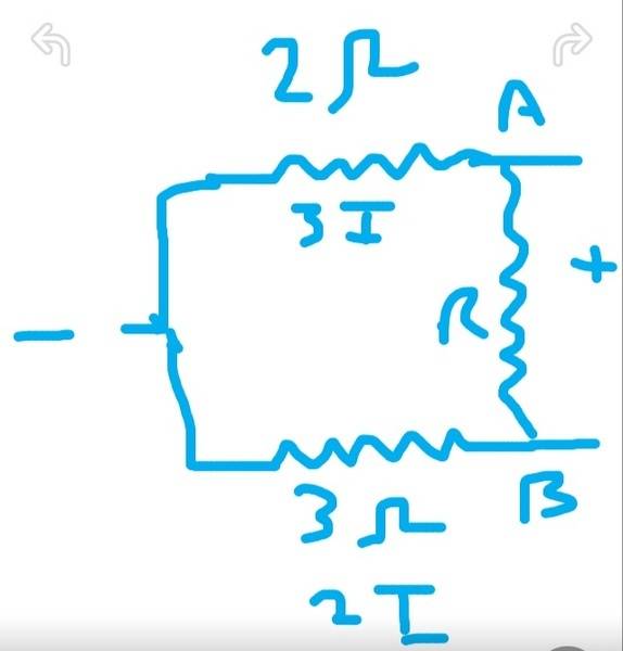

But a wire of resistance 3 ohms carrying a current of intensity 2 Amperes connected to another wire of resistance 2 ohms carrying a current of 3 amperes No current will flow between them although their intensities are different and quantity of electricity is different so there should be tendency for electrons to flow from high charge to low charge
I mean that the amount of charge at A is more that at B, Although no current will flow through R?

This is not a clear description of a circuit, and without additional information about the circuit it is impossible to tell if there will be a current flow.
If you connect two resistors in parallel, then different currents can flow through them. That should not be surprising.
A and B cannot be open ends, the current will flow to something else, so no charge is accumulating anywhere. Current is "charge per time" - and everything that flows in always flows out again (to a very good approximation).

Check the figure that I posted before your post

I don't understand what do you mean? I just want to know if there is going to be a current through R or not considering that the amount of charge at A is more than That at B
I changed my previous post (you can change posts after you posted them, see the "edit" button in your posts).
That depends on the remaining circuit, especially the connections at A and B.
There are no charges hanging around, neither at A nor at B.
thats the rest of the circuit
Okay. The 4Ohm-resistor has 3A as well (so it is between a voltage of 12V), and the 6Ohm-resistor has 2A (so it is between a voltage of 12V -> matches). As you can see, all electrons that come through the upper left resistor can go through the upper right resistor, and the same happens at the lower side. There is no current in the vertical line.
