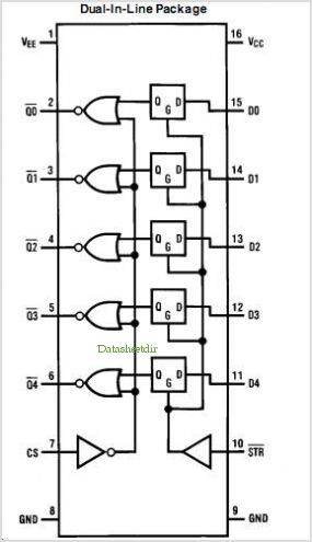

I assume that you write the Vout-value to some latch, connected to a DA-converter:
Here the /STR input is connected to the /WR signal and thereby a ZOH is included in your example, as the latch will "hold" the value until next sample period ( next output ).
Doing so physically, you must include it in your math. Otherwise the math-world will not match the physics-world.
