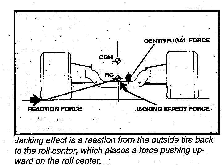

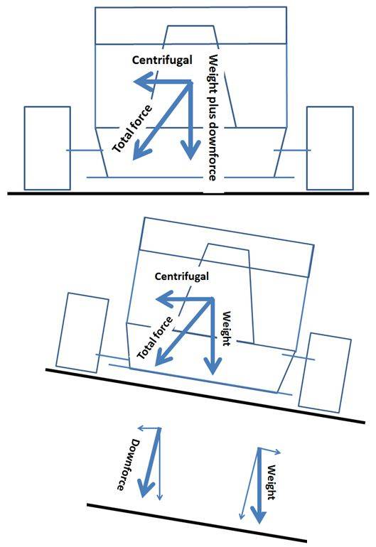

Body roll and RC location
Back on Page 14, post # 479 I used an illustration not to scale but relative to the point. The front Roll Center location matters greatly in the performance of the race car. Below illustration has the RC way up there at about 13” above the track. The Center of Gravity is about 16” above the track. Not to realistic. The pic below is a lot more real world with the Roll center up about 3 inch and 3 inch to the right of center. The CG is offset to the left 1 inch as most rules permit it.
Down force quick tutorial - Take a tire ( mounted on the wheel of course) and stand it up on its wide tread. Now facing the wheel Grip both sides like you are going to put it on the wheel lugs. Slide it on the garage floor. Slides pretty easy, right? Now have Lumpy the fat neighbor kid, sit on the tire and try this again. Sliding a 40 pound tire/wheel was easy but sliding a 165 pound tire/wheel/ fat kid set up is way more difficult. This is what happens when you add DOWN FORCE. More grip.
Increasing the amount of vertical downforce on the right front tire increases the available traction, but in a non-linear way. When you increase loading on a tire, it will gain traction, but not in constant multiples. Adding 706 lbs down force adds traction but if we double it the results will not double the traction. The amount of traction will be something less than 2 times.
Big Bar and Soft Spring setups - This setup limits body roll in an attempt to place more load on the left-side tires, leading to more equally loaded sets of tires to produce more traction. One major factor is to limit the air under the car and kill off lift. Initially when this set up developed ride heights were about 4 inch track to chassis now it is 3 inch. Everyone is going lower. This and a more aero body adds downforce on the car body to provide tire loading. You still need to take advantage of RC location to properly load the right front tire.
Per attached pic note - IT is not to scale so pay little attention to the appearance as it is not to scale but close approximation.
Left RC has a 5° angle to the right front tire contact patch. The Right side RC has a 7° angle. This is the jacking effect that can lift the left side tire if it is great enough. Remember the sprint cars carrying the left front tire off the ground thru the turns. This happens when the roll center is placed too far to the right of centerline.

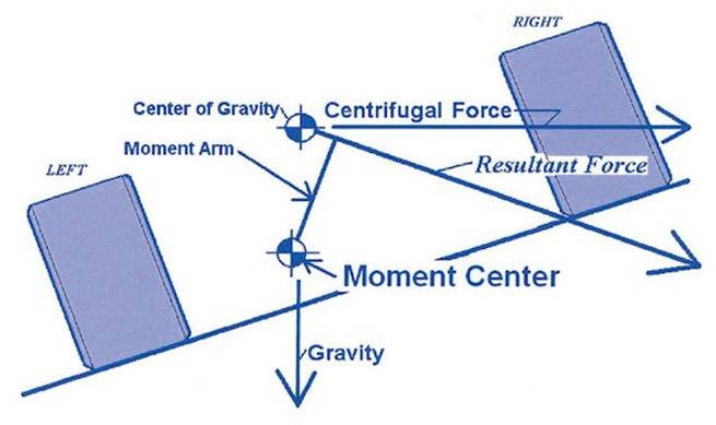

Note the moment arm or lever length between the CG and the Rt RC are very close, less than 0.40 " inch length.Now let us look at what happens during cornering. Momentum will continue to travel in a straight line until another force changes the direction. In this case the tires will do this through the suspension linkages.
Now let us look at the MASS that will have Momentum and must be dealt with before the car starts pushing like a freight train. Typical Late Model car min wight limit is 3000 lbs.
Of this, Unsprung weight of quick change, coil overs (50% unsprung weight, sway bar (ARB), upper control arms) amount to 400 lbs. We need to handle 2600 lbs. mass.
On a typical race car the front to rear weight is 52-48%. Caution- the calculations here are not going to be accurate but are close enough to demonstrate the need for proper location of the front roll center. In this example 52% of 2600 lbs is 1352 lbs.
This Mass will continue forward or diagonal once the tires cause opposing force on the MASS. One force vector is from the right front tire to the Roll Center.
If we know the Angle Sine of the left RC has a 5° angle has SIN of 0.087. and we multiply this by the 1352 Mass we have 118 lbs. acting on the tire contact patch thru this vector and the remaining 1234 lbs. moving laterally to the outside of the track. But wait a minute. What also is happening during the cornering process.
The typical late model car has 34” between the front spring upper mounting points. Our left roll center is offset 3 inches to the left which means 42% of the body roll will act on this RC. We have 42% of the Mass moving thru the RC rotating and planting the right front tire with 518 lbs. downforce. The remaining 716 lbs. is moving laterally and pushing directly on the tires.
Now let us look at the Angle Sine of the right RC, 7° angle has SIN of 0.121 and we multiply this by the Mass we have 164 lbs. acting on the tire contact patch thru this vector and the remaining 1070 lbs. moving laterally to the outside of the track. But wait a minute. What also is happening during the cornering process.
The typical late model car has 34” between the front spring upper mounting points. Our right roll center is offset 3 inches to the right. Now we have 58% of the body roll rotating thru this RC. We have 58% of the Mass moving thru the RC rotating and planting the right front tire with 690 lbs. downforce. The remaining 500 lbs. is moving laterally and pushing directly on the tires.
Feature ................................ Left RC......................Right RC
Downforce on rt ft tire......518 lbs...................690 lbs or 25% more downforce
Force lateral thru tire...........716 lbs..............500 lbs or 30% less side load
Jacking force rt ft tire............118 lbs.................164 lbs
I would prefer 25% more down force on the right front tire and handle the momentum with this set up as opposed to the left side roll center method.

  • #1,655

  • #1,657
Left RC has a 4° angle to the right front tire contact patch. The Right side RC has a 6° angle. This is the jacking effect that can lift the left side tire if it is great enough. Remember the sprint cars carrying the left front tire off the ground thru the turns. This happens when the roll center is placed too far to the right of centerline.
Note the longer moment arm or lever between the CG and the Rt RC.
If we know the Angle Sine of the left RC has a 4° angle has SIN of 0.07. and we multiply this by the 1352 Mass we have 95 lbs. acting on the tire contact patch thru this vector and the remaining 1257 lbs. moving laterally to the outside of the track. But wait a minute. What also is happening during the cornering process.
The typical late model car has 34” between the front spring upper mounting points. Our left roll center is offset 3 inches to the left which means 42% of the body roll will act on this RC. We have 42% of the Mass moving thru the RC rotating and planting the right front tire with 528 lbs. downforce. The remaining 1402 lbs. is moving laterally and pushing directly on the tires.
Now let us look at the Angle Sine of the right RC, 6° angle has SIN of 0.10 and we multiply this by the Mass we have 135 lbs. acting on the tire contact patch thru this vector and the remaining 1217 lbs. moving laterally to the outside of the track. But wait a minute. What also is happening during the cornering process.
The typical late model car has 34” between the front spring upper mounting points. Our right roll center is offset 3 inches to the right. Now we have 58% of the body roll rotating thru this RC. We have 58% of the Mass moving thru the RC rotating and planting the right front tire with 706 lbs. downforce. The remaining 511 lbs. is moving laterally and pushing directly on the tires.
Downforce on rt ft tire......528 lbs...................706 lbs or 25% more downforce
Force lateral thru tire...........1402 lbs..............511 lbs
Jacking force rt ft tire............95 lbs.................135 lbs
Hi RM
I like this site there is a lot of things you bring to light and explain in a way to make it easy to under stand. There is a couple of things in this post don't sound right to me. One is that the BBSS car has more inside load and the only things that can can change load transfer with a given velocity and turn radius is the track width and COG height. There may be a slight change from COG not rising but that is probably controlled more with jacking forces.
The other thing is your explanation of load transfer on front end verses roll center height. This has the same argument as above, RCH, spring rate, and jacking effect can not change load transfer only how fast it takes place and how its distributed. RCH determines how much of the load transfer is handled by geometric forces and elastic forces. Any jacking forces that happen are subtracted from the elastic forces, or the difference of how much the inside spring got lighter and the outside spring got heavier.
So I don't think it matters where you put the roll center height or lateral position the steady state vertical load on the RF tire, in the turn, will not change. The lateral force on the front will be the static weight of the front end times the lateral G force, on a flat track, a little more complicated for banking. Please let me know if you think I have something wrong.

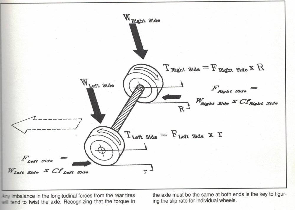

Why does the car drive straight to the wall when I give it the gas?
History - Remember back in the muscle car day. The 426-cube engine would torque up the left front. Many motor mount broke as the rubber mount would separate. We had to put a chain on the left side of the motor and chain it to the chassis. Engine torque would twist the car lifting the left side up and and add load to the right rear tire. The car would swerve left when you dropped the clutch at 7000 rpm. Look on a Saturday morning for the rubber tire tracks showing this on any country road after the hot rodders had fun the night before. Tire marks going to the left !
Right rear tire was loaded, the rear left side tire was unloaded, car shot to the unloaded side, instant push under acceleration. Factory engineers realized this and the big cubic inch cars had 7 leaf right rear springs and 6 leaf left rear springs to counter this. Otherwise, you had a built-in push under acceleration to the left. So why does the hot rodders still shoot to the left? They stuff a high horsepower V8 into a grocery getter designed for the 6-cylinder low HP engine without fixing the rear spring situation.
Factory late model chassis builders , great craftsman like Howe, Port City , Left Hander etc. built late model race cars and sold them. A great value but all in all generic as they did not know what track, or the track rules or conditions the car would race. It saved huge time for the small race teams. They had one great a platform to finalize. Here is the problem.
Usually the car was sold with 4 race wheels to accommodate the track rules regarding tire size. You had to race 10-inch tires max, so you got 4 ten-inch-wide tires and appropriate wheel. Makes sense No one is a mind reader. Again, the rules for the cars would vary all over the places different tracks had different rules on engine offset, % left side weight. maximum track width etc.. goes on and on. You got a generic , well built , safe race car that out of the box was pretty darn good.
Discussion
The car probably had 1 inch engine offset to the left as this was pretty universal. The factory car was set up with at most 52% left side weight. This is still the norm, I think. The majority of racers today are running these older chassis unless you have cubic money and buy the latest greatest new chassis. The big problem is your race team decides on where to put the weight and what wheels to use.
Wheels - factory chassis guys like Howe, Port City , Left Hand ship the car with standard wheels on all four corners. Normally the wheel has 4 inch offset measuring from the back of the wheel to the wheel backing plate. Saves money and is a good baseline. If you take the 4-inch offset wheel off the car and put 3 inch offset on the right side of the car and 5 inch offset on the left side of the car you gain left side weight. You can gain 2% more left side weight doing this. Now you are at 54% left side weight. Now you add a 1-inch spacer between the hub and the backing plate so you can get up to 56% left side weight. Some even go radical using 6 inch offset wheels. Next you find out the track has a 58% maximum left side weight rule, so you move weight around to do this. Now you are at the legal 58% left side weight.
The problem
The location of the top link on any factory chassis is about a 52% left side weight set up on the standard 4 inch offset wheels and the tire track width. A very logical and safe starting point. Unless you ordered it with a specific requirement to change these settings. No one does this because no one knows about this Post!
The problem is the 3rd link is mounted at the original 52% weight location and should now be at the 58% location and it is not.
Why is top link mount so critical? The top link is the rear end link that pulls the race car. This top link directs all rear end force to the chassis. The rear tires grip the track and try to pull the rear end to the rear as the trailing arms. On the bottom, the trailing arms push the car to the front and try to climb up under the car.
We are discussing left turn race car where you want a left side weight bias. When in a turn you want the left side weight rolling over to the right side to assist the car with better traction (tire grip). Correct location of the 3rd link mounting is a real help so the tires are pulling on the third link equally otherwise when you step on the gas, one tire will bite more than the other and shoot you toward the outside of the track or the inside.
If the 3rd link is offset to the left more than the right side, the left will have more load and the right rear tire will have less load. Exactly opposite of the muscle car scenario above. What really happens is more force is added to the side of the car the link is biased to. In this case we have more force added to the left rear tire, so we create an on gas, corner exit PUSH condition.
The Cure
Mark each rear tire centerline. Measure the distance between them. This is the track width. Let's say 66 inches so the mid-point is located at 33 inches. Now measure the right-side tire centerline to the middle of the top link. Let's say it is 34 ¼ inches. 34 / 66 = 52% left side weight. If you are scaling at 58% left side weight we multiply the total track width time the % so 66" x .58 = 38 ¼ inches. The top link mount should be at 38 ¼ " so, move it left 4" then the push goes away. It is that simple to fix.
See attached photo a forum member, RaceMan12 posted on page 46 post 1602 this post. You can make this happen.​
Look at photo below. Notice the original top link mount was offset about 1 ½ inch to the left of the quick-change housing centerline. The racer relocated it about 4 inches more to the left.See post # 1576 page 46
post 1602 page 46
post 1604 page 46
this explains things in a lot more detail.
Likes Tom.G and Savem c10
  • #1,661
UFO said:
Hi RM
One is that the BBSS car has more inside load and the only things that can change load transfer with a given velocity and turn radius is the track width and COG height. There may be a slight change from COG not rising but that is probably controlled more with jacking forces.Totally Wrong. *I have intentionally not factored in acceleration ( G force is a measure of acceleration). This would complicate the issue. Turn radius, COG height, RC height have no impact on the force of the car going into the turn. When the car gets to the max apex of the turn the only consideration is how to deal with the force of the momentum. Granted, the more Aero downforce you can apply before the turn the more the sprig package will compress. On ½ mile tracks this is a factor.
Only a few things can change inertia or resistance to change of direction. The tire traction, aero drag or the wall. COG height, Roll center height only change when the springs and ARB ( sway bar ) compress.
The other thing is your explanation of load transfer on front end verses roll center height. This has the same argument as above, RCH, spring rate, and jacking effect cannot change load transfer only how fast it takes place and how its distributed.

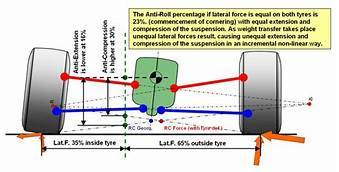

So, in fact, by your own words, RCH, spring rate, and jacking effect do change load transfer. Glad you acknowledge this.
I see I am making progress here. I assume by geometric forces you mean force vectors. By elastic forces you mean the springs, sway and tire adhesion handle the above forces.
Yes, any jacking effect is subtracted from the requirement this remaining force that must be dealt with by the tires or the wall. This momentum is not going away.
This is why I seek not to reply much to your questions. Steady state load on the RF tire will not change???? You think body roll thru the roll center does not impact right front tire load ( more traction)?
*Which is why I choosing to not complicate matters. Yes ,it does and you still must deal with it or hit the wall.

More on RC migration later but as long as the roll center stays to the right of the centerline and orbits within 3 inch of original position, you are good.
Next make sure Bump steer is good.
Also look at camber build on right front.
This is a lot of work but camber build and tire patch is critical on right front.
If you get a chance let me know right front dive ( shock travel) as this is the limits you have to work with.
Do not seek perfection as this is a bull ring car and all you need is have a superior set up versus the other racers. One thing I absolutely know is, unless you bought a new chassis from the factory, your car has been beat on and hacked up and no where near specs when it originally shipped.
Savvy?

Regarding Roll Center acting on right front tire contact patch.
Look at the diagram. We have a block placed on a slope. The forces acting on t his block are its Mass and Gravity.
Parallel force can be found using the formula: Fparallel = m * g * sin(θ) where:
Fparallel is the parallel force, - m is the mass of the object, g is the acceleration due to gravity (approximately 9.8 m/s2 on Earth), and θ is the angle of the inclined plane with respect to the horizontal.
For this exercise we can leave out G as gravity will effect both Roll Center setups the same. This leaves the equation Fparallel = m * sin(θ). or W times Sine θ
Note - θ is Theta angle in degrees.
For our race car we have the sprung weight of the car going into the corner and pushing from the Roll Center to the rt ft tire contact patch. If we know the total mass as previously calculated in the above example post # 1674, we have to deal with 1352 lbs. pushing directly on the rt ft tire contact patch at an angle of 11°
Sine of θ from Trig tables -
Sine of 90
° = 1
Sine of 45° = 0.70
Sine of 30°= 0.50
Sine of 11°= 0.19
Sine of 5° = 0.08
So you see when you multiply 1352 x 11° angle with Sine of .19 = 257 lbs.
Now compared to 1352 x 5° angle with Sine of 0.08 = 108 lbs.
the smaller the angle, the less force results, everything else being equal.
This is why we always want to apply for at 90° to the object to get maximum applied force!
