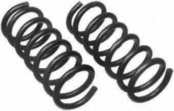

  • #1,696
RM-
I am trying to select a good starting spring package for my asphalt late model and have read your post about selecting starting spring rates post #19. I'm surely not the smartest person at figuring things out so I am a bit lost on calculating the wheel rates and converting it to spring rates. How does one figure out the G-force going through the corners at their home track? And wouldn't it change as we get the car faster through the corners thus changing the G-force and needing a different set of springs? When I first got this car it had 275s arcoss the front and 150 LR and 225RR with a 1 1/8th front sway bar, do you think this would be a good starting point for a tight 1/4 mile, 7deg. banking track and my car weighs 2750 w/driver. Any info. would be great!
  • #1,697
And we aren't allowed to run bump stops so I'd assume we would have to run a more conventional spring setup!
  • #1,698
welcome cape
first look at the index on page 1. note under spring calculation i have post 19 page 1 and post 589 page 17 going in detail how you can measure Gs in your turn.
assuming the 1 1/8 inch anti roll bar is solid and 36" long with 12" arms you have 220# spring rate
typical spring package for your weight car is 330 LF, 325 RT FT, 175 lft rear, 150 rt rear, if you run a frt roll center 2 1/2 to 3 inch high with 3 " offset to the right
please read post 1660 on page 48 and tell me the location of your 3rd link. i suspect the 225 rt rear spring is on the car because the 3rd link is not properly located.
