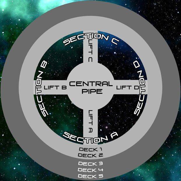

The corridors on the inside are 32 m wide. Since I want the rings to dismantle and break down into their subsections A-D at the end
There are of course many ways this could be designed (at least for a story), but I would imagine that the doors (which has to be full pressure doors assuming the ring sections are to maintain pressure after separation) are not required take up the entire 32 m of depth with the additional design problem of where to store that door that this incurs. You could for instance have only the central part of each level, say 5-10 m being open for travel between the sections, with the remaining length is just being part the hull and being used to hold a sliding or hinged door. Assuming there is no requirement to have doors the same full height as the levels, you could just have the door hinged at the top, thus storing the door as part of the (slightly lower) ceiling near each section division at each level, which also seems to allow for nice fail-safe emergency deployment. By the way, note that having the doors stored internal (in air pressure) is probably needed since storing them outside will make a chicken-and-egg problem of deploying them to their sealed position without letting all the air out first.
Also, depending on when section separation is meant to occur and how fast it happens you may also want to consider using double doors to allow for some redundancy.
Strato Incendus said:
Does 60 m inter-ring distance still work if I change B from 32 m to 64 m? As far as I understood, the graph you made is specifically for B = 32 m.
Yes, the graph was made for B = 32m specifically, but let me stress again that such a moment of inertia calculation considers only the geometrical distribution of he bulk of the mass, so having some part of the structure protrude from the ring in various directions shouldn't matter much as long as the mass of these protrusions are small compared with the total. The various values used for the graphs just means that the bulk of the mass is assumed to be distributed equally within the geometric shapes these values indicate.
What may be more significant to rotational stability than have some doors protrude is the fact that I did not include the mass of the spokes in the calculation. Having spokes is, regarding rotational stability at least, a bit like having an "effective" inner ring diameter that is smaller than the geometric inner diameter, and in general the stability suffers a bit when making that "effective" inner diameter smaller. Again, if the mass of the spokes are small compared to the rings and central pipe, then the effect will be small. For instance, I assume the spokes does not have to be 32 meter deep, meaning even if they have same average density as the rings their total mass will like be a small part only. But of course, when in doubt a good engineer always verifies such assumptions by a calculation :wink:
The only places where the pipe does reach its full 100-metre ceiling height now (i.e., the full diameter) is at the hub of the rings. If the hub sections in the pipe rotate, too, I guess this would create some small levels of gravity in those sections of the pipe?
The level of rotational gravity scales linear with distance from the center. So if you have 1G at the outer ring radius, then at 0.2 times that radius you would have 0.2 G.

I guess this would be a good time to discuss water consumption on board in general. My natural intuition was that water would be scarce, so the amount of tab water to be used per person per day would be strictly limited. This is what led the main couple to take their showers together.

Happy to! :) Glad I can contribute something to the calculating work, even as a layman:
Using SpinCalc as a reference, since it was suggested here:
Ring Radius: 250 m
Inner Ring Diameter: 500 m
Outer Ring Diameter: 526 m
Inner Ring Circumference: 1,570 m
Outer Ring Circumference: 1,652 m
Inner Ring Thickness: 32 m
Outer Ring Thickness: 64 m
Angular Velocity: 1.9380115679324463 rotations per minute
Tangential Velocity: 50.737024203238406 meters per second
Centripetal Aceleration: 1.05 g
The radius of the pipe is 50 m (diameter 100 m), as we have established earlier in this thread.
Don't worry, the "most technical" details like angular velocity and tangential velocity probably won't end up in the book. ;) Rather, I need to show how physics on board behave as a result of these variables. But in order to be able to do that, I first need to have an idea myself of what these effects would look like in practice.

Ring Radius: 250 m
Angular Velocity: 1.94 rotations per minute
Tangential Velocity: 50.74 meters per second
Centripetal Acceleration: 1.05 g

In fact, we can use images here - just not anything that has been used for promotion already, as far as I understand it?
My ship is rather "boring-looking" from the outside, too: Just a long pencil shape with the five rings wrapping around it. So here is a very crude depiction of it (using the same public domain background as on the previous page of this discussion).
Since I made this image, the rings became wider and the distance between the rings shorter. So we'd probably have to imagine the ring width and the sections between the rings to be almost equal in length (64 metres ring width, 60 metres between-ring distance).
On the previous page of this thread, I have already uploaded a cross-section of one of the rings, with the central pipe in the middle.
This is not to scale yet, since we haven't decided on final measurements so far.
However, as it currently stands, the diameter of the trunk (central pipe) is 100 m, the inner diameter of the rings 500 m (given the height of the five decks etc. discussed previously, the outer diameter of the rings is 526 m).
Regarding the bridge section, I wanted it to remain in a fix position relative to the direction of movement. Hence, I could not place it on one of the rotating rings. So the question is how to ensure something that resembles regular walking on the bridge. In The Expanse, they have the magnetic-boots solution. This might work well for the crew working on the bridge normally. But for the rebels storming it at the end of the mutiny, it seems unlikely that they would all have access to such magnetic boots.
