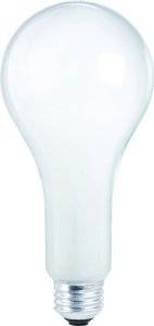

Well, OK. Here's a 300W 6300 lumen tungsten:
https://www.fastenal.com/products/details/0710993
Though I'm not sure these giant mostly-vacuum bulbs are susceptible to fingerprints like tiny halogen.
