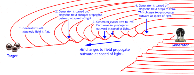

Going back to you original post:
Tominator said:
Well, ok, but if the magnetic field (generated by EM oscilator, with AC current) was for example 1km vast (from it`s source), with frequency higher than 75 kHz, then the magnetic field would have to travel the trajectory of 4km in one period (it would have to expand to 1km distance and diminish back, then reverse polarity and to 1km and back) faster than 300000km per s.
I'm seeing a fundamental misconception.
It seems to me, you're thinking there can be only one cycle between source and target. Thuis is tantamount to saying that there can be ever be one wave crest between boat and swimmer. Not true.
See attached diagram.

In the picture you have posted Dave, you assume, the generator was off in the biginning, but I meant it was turned on before. That is why I asked about the change, when we turn it off.
There wouldn't be any fluctuations/changes in the field before the generator was turned off.
pallidin said:
If I might add, the issue here is with respect to switching the on-off state of an electromagnet at c.
This is not possible under classical configuration.
What's needed is a technological technique to c-switch. This might involve a radical approach, and likely very expensive.
Because the distance between generator and electromagnet is long enough, it would take some time for the change to reach the electromagnet, so this would not require c-switch. Meanwile, the electromagnet would bounce off the magnetic field. Could it bounce off the field with generator just turned off? Because as long as I know, the field itself has almost no weight.
  • #35
I'm sorry, I'm just not getting this whole contraption. I think you're overcomplicating it.
Any and all changes propogate at the speed of light. That's all I've got.
