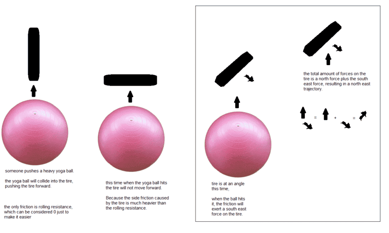

Helps if u just view a tire as 1 component instead of studying the whole car.
Just like go to your backyard get a tire. Or just get a lego tire. The tire will resist sideways motion. So if the tire is at angle (lets say the angle is 1:00 or 2:00 clockwise). Its going to exert a force south east. This will result in a trajectory of north east.
Now attach that tire to the car, and use that as the front tire, and then add a motor to the back tires of the car.
The motor pushing the back tires is basically the same as the yoga ball.
This means the car will push the front tire the same concept as the yoga ball pushing the tire. This means the car will get an east pushing torque from the front tire, thus will rotate.
Another way to think of it is like this. Friction always offers a force opposite of motion. A tire has a heavy side friction and the longitude friction is the rolling resistance. So even if the car is sliding, there will in most cases be more side friction than longitudal friction.Another example is if brakes are applied (no ABS.) The tire will not be able to spin. Therefore the friction will just behave like a normal object roughly equal in both directions. Therefore the car will not turn, hence they invented ABS (antilock brakes.)
Likes crudux_cruo

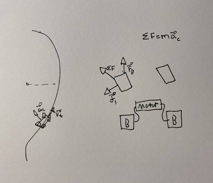

I spent some time working through some problems and rereading this thread, and hopefully that did some good.
I drew this chickenscratch really quickly and was curious if you felt that it was roughly accurate? I only did the forces for one of the front tires for simplicity, and I'm having a bit of trouble conceptualizing the entire car as a system but hopefully I'm closer than where I started out.
Hmm, I am not sure what these letters are.
