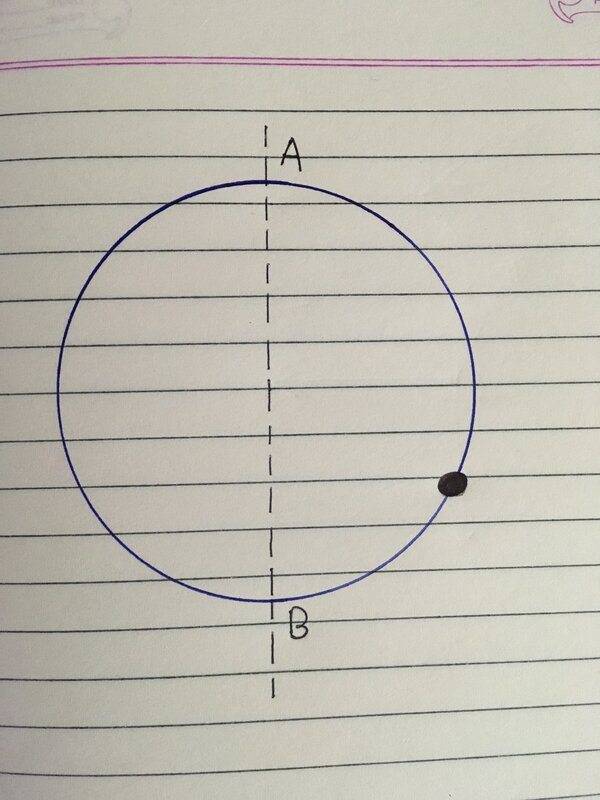

Situation: Let’s say we have a wire bent into a circular shape, there lies a bead through the wire and it can slide through it. The wire is kept in vertical plane and is swung along the axis AB.
My question : How the centripetal force is provided to the bead?
The bead will go into a circular motion as well (the wire is being swung in the vertical plane) and force acting on the bead are : gravity, and centripetal force. By help of Perok and haruspex, I know that centripetal force is just a component of forces (like tension, normal) it’s not something which exists on its own.
When we tie a stone to the rope and swing it round the circle in a horizontal plane, it is the tension force which is causing the centripetal acceleration (acceleration towards the center) and this tension exists because we are pulling the stone towards us, hence it’s we who are actually doing the real work.
But in the situation that I have described at first, I cannot seem to imagine how the centripetal force will ever come into play. How swinging around AB would provide the the centripetal force to the bead? Will there be some stretches or starins? Some people are saying that there are two forces acting on the bead when it swung: gravity and normal force from the wire, and it’s the horizontal component of the normal force which is causing the centripetal acceleration. What I don’t understand is why the wire would push the bead normally at all? (Well, I know why it cannot push tangentially, because we have assumed the wire to be friction-less hence all the forces from the wire will be perpendicular to it) but why wire will push the bead normally? What causes it to push on the bead? A mere contact cannot produce a normal force, we have to have something more because two pens touching each other on my desk aren’t pushing on each other apart until I push them together.
I hope I made myself clear, I tried my best to explain myself.

If you sit on a merry-go-round (I won't ask why...), and it starts to spin up, you'll "feel" yourself getting pushed back into your seat away from the axis of rotation. This "force" pushing you back is a consequence of analysing the motion in a rotating frame of reference; i.e. a pseudo-force which exactly balances the horizontal normal force. In the lab frame, the only horizontal force present is a normal contact force between yourself and the seat, which exists to provide the necessary centripetal force.
The rotating wire frame and bead really isn't much different conceptually. In the rotating frame of the bead, the bead gets thrown away from the axis by a centrifugal force causing the bead and wire frame to come into contact, producing that necessary reaction force. Switch back to the lab frame, and this normal force is still necessary to keep it going around in a circle.
It would be easiest to see if you try and build some sort of physical model and spin it around. The bead is "thrown" outward, and the inner face of the bead suddenly comes into contact with the wire frame. I think I drew a pretty picture of the interface in the previous thread. This one's not so pretty, and the bead/wire frame should be in contact (i.e. there's a gap drawn here), but I think it illustrates what you might be confused about:

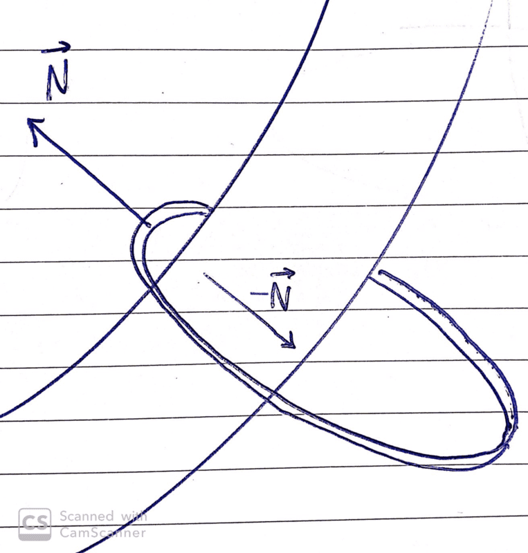

But centrifugal force will act perpendicularly away from the axis AB while the normal force will act towards the center of circle, not perpendicular to AB.
That's right; though we need to be careful since there are two circles in question here. The circle traced out by the bead and the circle of the wire frame. The normal force points toward the centre of the wire frame, so there is a horizontal and vertical component. In the rotating frame, the vertical component balances weight and the horizontal component balances the centrifugal force.
Look at a spherical pendulum swinging in a horizontal circle at constant ##\omega##.
Look at the bead in the wire going around in a horizontal circle at constant ##\omega##.
What's the difference? The force producing the acceleration is the same; only its name and origin differ. In the pendulum case it's called "tension" and is provided by the string, in the bead case it's called "normal force" and is provided by the wire. The free body diagrams are identical and so are the accelerations; if you understand one, you understand the other.

The segment of wire that is in contact with the bead accelerates, because its velocity is continuously changing direction. What do you think keeps the wire loop going around at constant ##\omega## if not some kind of force external to it?
Suppose you're right and there is no normal force acting on the bead.
Question 1: What other force is there acting on the bead?
Answer: Gravity, nothing else.
Question 2: What if gravity alone acted on the bead?
Answer: The bead will be in free fall and at best it will describe a parabola in a vertical plane.
Question 3: Then how come the bead goes around in a horizontal circle?
Answer: There must be an additional force that prevents it from undergoing parabolic motion and constrains it to undergo uniform circular motion in a horizontal plane.
Question 4: What is the name of that force and what entity provides it?
Answer: ##~~\dots##

The name of that force is Centrieptal force and it’s the horizontal component of normal force provided by the wire, therefore, the entity is wire.
"Centripetal" denotes direction and means "directed towards the center". It is not a special kind of force. Although the horizontal component comes from the normal force, it is better to think of this in terms of the net force, (the sum of all the forces) that is centripetal; the acceleration is also centripetal and Newton's 2nd law says that the net force and the acceleration mst be in the same direction. Stated differently, at all times the resultant of gravity and the normal force is in the horizontal direction and provides the observed acceleration. Had you drawn a proper free body diagram, you would have seen this. The normal force act in the radial direction as shown in the drawing by @etotheipi in #2 and gravity acts vertically down. The fact remains, if the wire did not push on the bead, the bead would be in free fall.

But how the bead is coming closer to the wire for normal force to act on the bead?
The wire moves in a circle, while the bead has the tendency to stay at rest of move uniformly along a line, due to inertia. These two motions are not compatible, so there must be a collision at some point.
