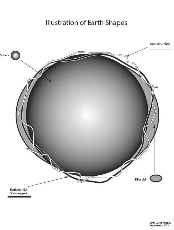

Forever. It will stay in place. The geoid is not a sphere.

The difference does not have a lot of zeroes. Only about three. And the effect is enough to get to the equator the requisite time frame. One gee times several hours times 10-3 adds up.

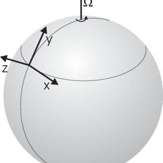

can the object orbit around the tropic of cancer? so there must be another acceleration component, no?
  • Reference-frame-for-the-calculations-The-z-axis-is-chosen-to-point-away-from-the-Earth_Q320.jpg

The geoid is an equipotential surface in the rotating frame, so there is no drift along its surface per defintion.
A.T. said:
The geoid is an equipotential surface in the rotating frame, so there is no drift along its surface per definition.
so that 0.5% change in radius, keeps the surface equipotential? Its been a while since I've dabbled into this , but this sounds like it would allow for a higher latitude orbit.
