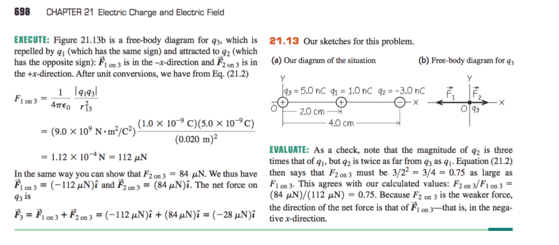

I have made assumptions to simplify the matter, since the examples I was looking at were introductory (which are never complete in the first place). In fact, I suspect these examples to be the source of my confusion.
For clarity, I’ll post the example problem. Please take it as is, and no more.
Thanks:)
The initial problem
Sears & Zemansky's University Physics w/ Modern Physics 13th ed., Young & Freedman, 2012
Thanks:)

So what’s the issue here? How does this problem somehow resulted in this thread?
Zz.
Zz.
There is a net force, the particle isn't in equilibrium. Coulombs law, based on electrostatics or equilibrium (from what I understand).
1) How can there be a net force if the particle is in equilibrium?
2) If the particle is not in equilibrium, how does Coulombs law apply?
These were all my original inquiries, wether or not I made that clear.
Thanks:)
Indeed, the problem is one where Coulomb’s law is not clearly applicable. I assume that in the broader context of the chapter it is obvious, but I agree with your objection in the specific context of this problem.
Often simplified laws are applied even when the exact assumptions are violated. In such a case it is important to understand when you can get away with the approximation. Chapter 3 below is a good explanation

I'm terribly sorry, but I've made a mistake. The entire problem wasn't shown...
Dale: I'm unsure wether your reply would change. Thanks for the book! Although, it seems too advance at first glance. But I hope to get to this point.
ZapperZ: My mistake aside, from the FBD alone, the particle would have to be in motion or impending motion. This is where you lose me.
Thanks again:)
Sorry for the mistake:(
http://web.mit.edu/6.013_book/www/book.html
Yes, it does change. The additional information clearly specifies that the charges are at fixed locations.
True.
The particle is not in equilibrium.
Because the particles are not moving.
Likes Jurtinus
  • #34
Coulomb’s law clearly applies as specified.
The FBD seems incomplete.
What if it is not. Could Coulombs Law alone suggest the impending motion of a particle at an instant, without the need of additional conditions? Such as Coulombs dry friction, covered in engineering statics.
Thanks:)
  • #35
Thanks again:)
The FBD has nothing to do with the particle being in motion or not. The FBD shows the forces acting on the particle at that particular instant at that particular location.
If you let the situation continues, then the particle will move, and now, we no longer have the same situation as before because at a different location, the forces will be different. Furthermore, a moving change in a changing electric field (the electric field can be different at different locations) has other complications added to it that is NOT covered here.
You will deal with uniform electric field soon enough, and you'll see the case of charged particle moving in such a field. In that case, then you have the same kinematical equation that you had when dealing with particles in a uniform gravitational field.
Zz.
