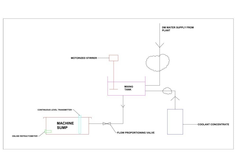

Hey guys,
I am designing a system that would monitor the coolant tanks of about 10 CNC machines through a centralized system consisting of valves, a pump & a refractometer. The system would be connected to the tanks through fixed piping in the plant.
A pump would draw small amount of liquid from each tank sequentially and an online refractometer will check the concentration of the drawn liquid. If the concentration is above or below the desired level, we have to initiate a coolant make-up (refill) operation which would actuate another pump that will transfer appropriate quantity of coolant & water in the right make-up concentration into the Coolant Tank.
I have a few queries which I would highly appreciate if you guys could throw some light on :-
1. Can I use one single centralized pump to draw liquid from 10 tanks (the machines may be as far as 50 feet from the pump) , because having one pump per tank is difficult due to the increased plumbing & cost. If it is possible, what type of pump would suit this application?
2. Make-up of coolant requires a formula in which I need to know the quantity of liquid in the tank. Are there level sensors that provide continuous measurement of the liquid in a tank?
3. While adding liquid into the Coolant tank, how do I measure the exact quantity of liquid flowing through the pipe? Can I use Flowmeters? What type?

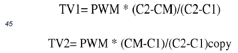

I'm imagining evaporation loss increases coolant concentration over time. Is there anything that ever thins it out? If no, wouldn't it be easier to add make-up water alone to restore concentration to the desired value?
It would be costly up front (and you'd have to factor in maintenance costs) but if make-up water is all that is required to maintain concentration, it may be cheaper in the long run to fit each machine with a refractometer, monitor continuously, and add water as needed.
Unresolved is what to do when it drifts out of calibration, and how to sense when that happens, but at least it will affect only a single machine.
Another thought: Although it exacerbates the effects of a single point failure inherent in a common system, what about radically lowering the level sensor in each CNC machine tank, and run a continuous loop of properly tempered coolant to use as make-up?

I'm envisioning each CNC machine has a sizable coolant reservoir. You propose to analyze and modify coolant quality for each machine from a central location, but to do so involves several difficult challenges. I'm wondering if it might be possible to operate with a bare minimum fluid level in the reservoir so there isn't a large volume of fluid to degrade, and use the central system to feed it with the desired mix of water and coolant.
The central system would consist of a mixing tank, water make-up valve, perhaps a peristaltic pump to meter coolant addition, and the refractometer. Coolant mixture would be pumped into a feed line that returns to the mixing tank fitted with drops at each CNC machine.
Each CNC machine would control a make-up solenoid valve to feed mixture from it's respective drop. Solenoid control could be done with two level switches slightly offset in height from one another ('make-up required' and 'make-up satisfied'), or by a single level sensor with timed hysteresis (start make-up at the high-to-low 'makeup required' transition, and use a time-off relay set to a suitably brief timeout) to prevent the solenoid valve from short-cycling.
With reservoir level kept intentionally low it is desirable to add another level sensor located somewhat below the make-up height to indicate when insufficient fluid is available to operate the CNC safely, and to provide a 'low coolant level shutdown' signal (rather than run without coolant until the tooling eats itself and the workpiece is damaged) for when the central makeup system goes off-line, CNC machine make-up valve doesn't operate, a massive coolant leak occurs at the CNC machine, etc.

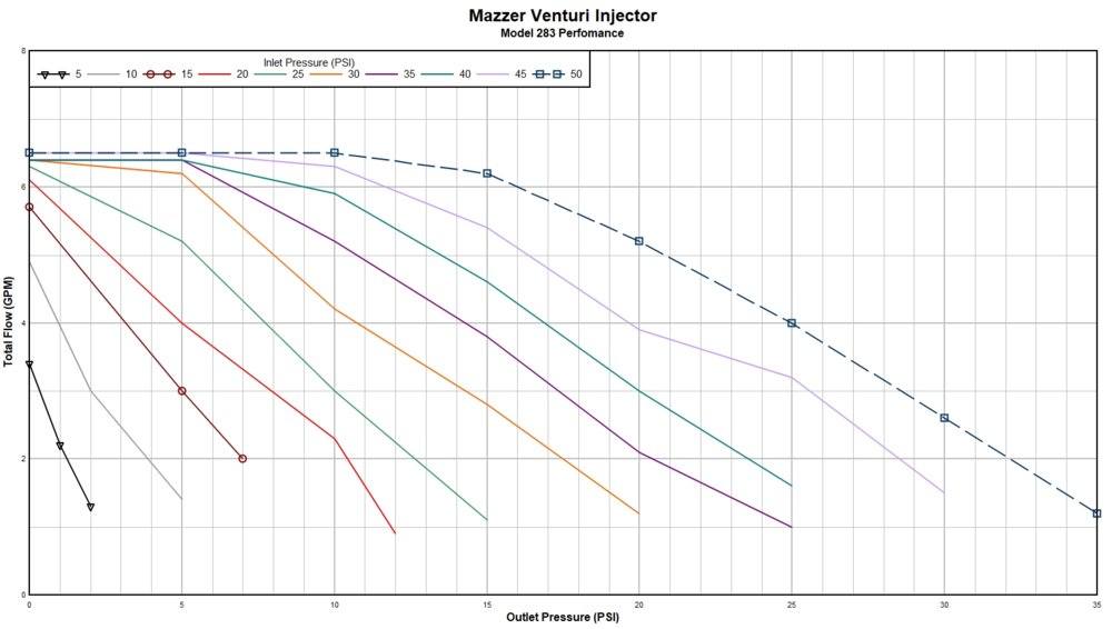

Hey guys, there are Venturi or water driven Coolant Proportioning Pumps available in the market. These pumps have a manual setting for maintaining the concentration.
Is there a way I can do this automatically? I mean, are there any such pumps that can be controlled by PLC i.e the opening size may be opened automatically be a solenoid valve and not by manually rotating a knob by hand?

Thanks for the suggestion. Firstly, if we have a centralized system that would actually feed the desired mix of water and coolant for about 10 machines, wouldn't I require a large volume of water & coolant in that centralized unit? Because I have to properly mix the coolant concentrate with water before feeding into the machine tank.
Mixing of coolant with water can be done using Coolant Proportioning Pumps. These are small, wall mounted or drum mounted pumps that operate on venturi principle and the accuracy obtained is pretty good.
The only problem with this is that the control of concentration is purely manual (knob rotation by hand) and I haven't been able to find any such pump that would operate completely automatically. Video of such a pump can be found in my previous post.

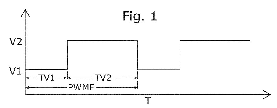

It would take some doing, but a geared stepper motor or small DC servo could be coupled to the shaft in place of the knob. Limit switches would typically be placed at each end of travel (CW and CCW) to prevent overtravel, and/or an encoder used for rotary feedback of valve stem position, and a control system built to drive it. Fairly costly.

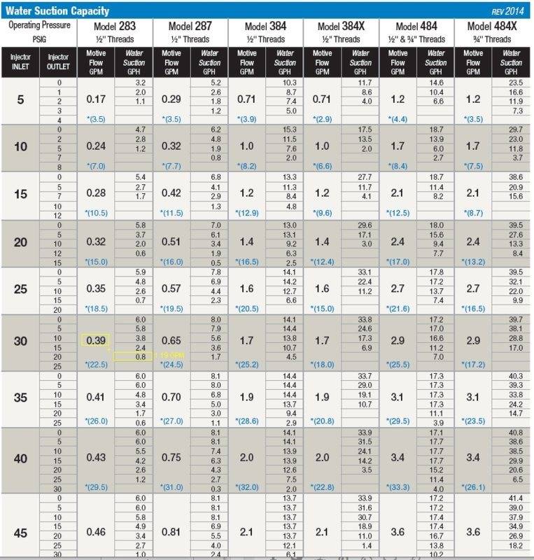

Groz doesn't provide enough information about this venturi mixer to determine whether it is worth the effort.
The two models indicated for metalworking fluids are CMX/1 (0 to 11%) and CMX/3 (0-9%) with both rated for 1100 liter/hour (290 gallon/hour) throughput at 57 PSI inlet pressure.

2. A pressure regulator in the water supply at each venturi pump would be required for any chance at mixture concentration repeatability. The regulator will have a sensitivity (how much pressure change is required to actuate a control response) specification. Will water supply pressure variation affect the resulting mix enough to matter?
Reply - A pressure regulator would be required, agreed. I am not sure how much a pressure variation would change the resultant concentration to be honest with you. We might just go ahead and build a prototype without a pressure regulator initially (once we're able to find a solution to all the other issues :/)
The pressing issue right now is how to mix the coolant & water in the desired concentration in an inline process. I have come across some documents mentioning use of Pulse Width Modulation. But I have 0 knowledge about this technology and even some research on it has left me clueless as to how the damn thing would work for this application (Link to the document - http://s000.tinyupload.com/index.php?file_id=07047886135675729106)

I've gone through this. It is quite in-line with what I have thought, but they have only designed that system for one CNC. It'll be a completely different proposition for say about 10 machines together.
Although it is pertinent to note that they do not use any venturi mixers and rely on the age-old method of a mechanical stirrer in a tank to mix coolant concentrate and water.
bobob said:
As I understand your question, you cannot do this, at least if you need to maximize the utilisation of all of your machines. Different materials and different cutting tools require different coolants and different operations require coolant to be supplied in different ways. (As an example of the latter, if you have a machine facing a piece, then there will be the coolant for that specific material being sprayed onto the surface, while if you are drilling through a different, or even the same material, you will probably be using a different coolant which is supplied through passages in the drill bit itself.) You could probably do this if all of your cnc machines are cutting the same material using the same type of cutting tool (i.e., carbide, TiN, whatever), but I think it will be less than ideal if you have one machine cutting aluminum with HSS and another machining stainless with some coated cutting tool. It will probably work ok if you don't intend to max out the machines to process parts as quickly as possible, though (and you don't have really strict requirements on surface finish). As far as I know, most cnc machines are self contained in that each one has its own coolant reservoir, but I could be mistaken about that last statement.
All of the various devices you mention could certainly be applied to accomplish what you are wanting to accomplish. The real question is that if you do build such a system, how will being tied to a common coolant system affect your ability to process multiple parts from different materials using different cutting tools?

An embodiment of the proposed coolant distribution system 10 uses two​
premixed streams of coolant at either extreme of a range​
of concentration, and to mix these two streams in the​
correct percentage to obtain the desired concentration.​
[0025] The desired degree of mixing is achieved by​
calculating a duty cycle for a pwm (pulse width modulation)​
signal to the valve 20 and to the valve 22 and adjusting​
the pwm duty cycle as follows:​
C1= Concentration of mixing valve 20​
C2= Concentration of mixing valve 22​
CM= Desired concentration for a respective machine 30.​
246072
PWMF = Total cycle time of pwm signal​
TV1= On time for Valve 20​
TV2= On time for Valve 22​
246073
[0026] In Fig. 1, V1 is valve 20 and V2 is valve 22 in the above description.​
For any reasonable cycle time ("PWMF" in their notation), let's say 10 seconds to make the math easy, practically any solenoid valve chemically compatible with the coolant ought to operate well.
The shorter the cycle time is made, the less accurate metering will become. It takes x amount of time for the valve to shift from full closed to full open position and visa versa, and this "in between" regime becomes a greater percentage of overall cycle time.

Sorry for the inactivity on this. Unable to come up with a solution for a centralized system, I have decided to pursue this for one Machine Sump initially and maybe add a machine or two to this just to avoid the insane amount of piping & valves that would be required to control 10 or more machines from one unit.
@Asymptotic , I am designing a system as described above and have encountered a problem. Please see this image :-
246658
I'll describe how this works.
1. An online refractometer & continuous level transmitter (capacitive or ultrasonic) continuously monitor the concentration & level of liquid in the machine sump. Both these inputs are fed to the PLC through 4-20 mA.
2. I have another mixing tank with a mechanical motorized stirrer. Depending on the inputs of concentration & level, I will decide the amount of re-fill required (how much volume at what concentration) using a formula which will be fed to the PLC. Refer this tool - http://www.qtstools.com/document_library/tech-resources/Coolants/Refill%20Concentration%20Calculator.xls
3. Now that I know how much liquid & concentration is required to maintain the sump at the desired volume & concentration, I have to fill the mixing tank with the exact amount of DM water (from the DM water supply) & coolant concentrate.
4. After mixing, the mixed coolant shall be transferred to the machine sump.
Now, I have a couple of issues here.
1) Depending on the input of current concentration & current volume of liquid in the machine sump, how do I fill the Mixing Tank with just the right amount of DM water & Coolant concentrate? Consider DM water shall be supplied through piping and not from a tank.
2) If I fill the mixing tank without metering or measuring the volume of DM water & coolant concentrate, can I use a Proportioning or Automatic Flow Control Valve on the outlet of the Mixing Tank? This valve would be synchronized through PLC with the Concentration & Level parameters to supply just the right amount of mixed liquid to maintain correct concentration & liquid level in the machine sump. But in this case, how do I know how much coolant concentrate to draw into the Mixing Tank? Using Venturi Mixers is not possible as the purpose of an automated system is defeated when you have to adjust the orifice opening everytime there is a change in concentration.
Any clarity on the above would be hugely appreciated.
  • #33
In post #31, I'm uncertain why a proportional valve is placed between the mixing tank and machine sump.
Seems to me this would control only the flow rate between mix tank and sump.
What range of concentration is satisfactory? For example, if the target is 3.5%, can the final mix vary between, say, 3.2 to 3.8% and still allow satisfactory machine tool operation?
  • #34
The diagram was a work-in-progress. My doubts regarding placement of the proportional valve where mentioned later in that same post. Still unclear whether proportional valves fitted at the inlet of the mixing tank to control flows of water & coolant could help? Individual valves for both of course..
Absolutely
