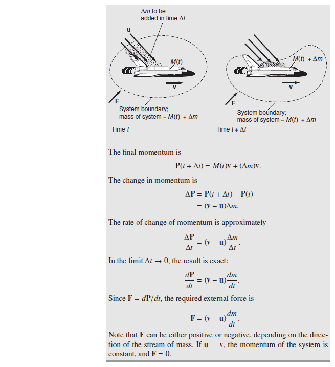

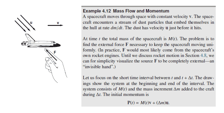

In this question, the particles are constantly transmitting their momentum to the rocket. The force required to keep the rocket stable can be express as ##\vec F=(\vec v-\vec u)\dot m##.
However, when I tried to solve this question using the Newton's 2nd law, I found that the infinitesimal change in the velocity vector in the first derivative is discontinuous, as shown below.
$$\vec F=\frac{dm{\vec v}'}{dt}=m\frac{\overbrace{d{\vec v}'}^{\text{disc.}}}{dt}+{\vec v}'\frac{dm}{dt}$$
After getting stuck, I tried to express the differentiation in terms of limit.
$$\vec F=\lim_{\Delta t\to 0}\frac{\Delta P}{\Delta t}=\lim_{\Delta t\to 0}\frac{\Delta m\vec{v}'}{\Delta t}=\lim_{\Delta t\to 0}\frac{\Delta m}{\Delta t}(\vec v-\vec u)=\dot m(\vec v-\vec u)$$
And it is the same as the solution in my book.
All in all, I would like to know why I have failed to find the solution by applying the chain rule to the 2nd law. Thank you.

Newton's second law only applies to constant mass systems. When the system is changing mass, you need to be very careful to account for how the mass is entering or leaving. For instance, if mass is accumulating with relative velocity ##\vec{v}_{rel} = \vec{u} - \vec{v}## to the spacecraft , then the 'modified form' of Newton's second law you need is$$\vec{F}_{ext} + \vec{v}_{rel} \frac{dm}{dt} = m\frac{d\vec{v}}{dt}$$Notice that in this example, ##m\frac{d\vec{v}}{dt} = \vec{0}## so it reduces to$$\vec{F}_{ext} = -\vec{v}_{rel} \frac{dm}{dt} = (\vec{v} - \vec{u}) \frac{dm}{dt}$$which is the result stated in the book. Notice that they were careful in their derivation to only apply NII to a system of constant mass!

That is the total force acting on the rocket but not the external force. If you use this expression for force, than you need to do it for both, rocket and dust. Than there is a force acting on the dust and therefore a corresponding counter force acting on the rocket. Let me show that with different symbols:
The force acting on the rocket is equal to the sum of the external force and the counter force from the dust:
##F_R = m_R \cdot \dot v_R + \dot m_R \cdot v_R = F_{ext} - F_D##
The force acting on the dust is
##F_D = m_D \cdot \dot v_D + \dot m_D \cdot v_D##
The dust is moving with constant velocity (##\dot v_D = 0##) and the total mass is conserved (##\dot m_D = - \dot m_R ##). This results in
##F_{ext} = m_R \cdot \dot v_R + \dot m_R \cdot \left( {v_R - v_D } \right)##
and with constant velocity of the rocket in
##F_{ext} = \dot m_R \cdot \left( {v_R - v_D } \right)##

Yes sometimes the ##\vec{v}_{rel} \frac{dm}{dt}## term is identified as the thrust. I think this not the best way to think about it, because although that term has dimensions of force, it is not a force so much as a correction term to Newton II. To think of that term as a force acting on the rocket is a somewhat slippery concept. Please refer to Kleppner and Kolenkow:
Recall that ##\vec{F} = \frac{d\vec{p}}{dt}## was established for a system composed of a certain set of particles... it is essential to deal with the same set of particles throughout the time interval... Consequently, the mass of the system can not change during the time of interest.

The most general case:
Force is the rate of momentum transfer.
A special case:
Net force is the rate of momentum change.
An even more special case:
For a constant mass system net force is proportional to acceleration.
Likes etotheipi

vanhees71 said:
It's always safe to use the conservation laws, i.e., momentum conservation of a closed system. E.g., to derive the rocket equation just consider the rocket as a "control volume" and use Reynold's transport theorem. This takes into account the correct momentum balance including the exhausted fuel which gives the correct equation given in #6.
Yes, it always works. However, when you ask for a force (like in case we are discussing here) than you need to include it into the momentum balace. With F=dp/dt for open systems this is quite easy. But if the second law is limited to closed systems than the derivation becomes ugly, with intersections into many small closed systems, difference quotients, limits etc. I do not see the benefit of limiting F=dp/dt to closed systems and than to do all these steps in order to make it working for open systems again.
  • #34
You get the forces for free when doing the momentum balance right.
Likes etotheipi
  • #35
DrStupid said:
With F=dp/dt it does. Again: You do not need to use F=dp/dt for open systems. It is your personal choice. But if you do it (even in the attempt to falsify it) then you need to do it consistent. You must not mix it with assumptions that hold for closed systems only.
@DrStupid I have a conceptually easier example. Now consider a mine-cart with a large-ish hole in the lower face, with no sand this time. Instead, you are standing inside the mine-cart, holding loads of metal ball bearings in your hand.
The mine-cart rolls along the frictionless tracks at a constant velocity, and then you begin to release the ball bearings from rest (in the cart frame) through the hole in the base of the mine-cart, at a rate of one ball per second.
Now there is absolutely no way in which there can be a horizontal force between the ball bearings and the mine-cart/you, since you're just dropping them through the hole, imparting no horizontal impulse. Consequently, the mine-cart undergoes no acceleration.
You can now imagine taking the continuum-limit of this process.
Now, if you were to apply your equation, ##\vec{F} = \vec{0} = \dot{m}\vec{v} + m\dot{\vec{v}}##, to the mine-cart, you would find that ##\dot{\vec{v}}## would be non-zero. How would you explain this? How would you also explain that ##\dot{\vec{v}}## would depend on your observational frame of reference?
The resolution is that ##\vec{v}_{rel}## has zero component parallel to the direction of motion, so then I use the modified equation ##\vec{F} + \vec{v}_{rel} \dot{m} = m\dot{\vec{v}}## to deduce that ##\dot{\vec{v}} = \vec{0}## (external constraint forces with the ground prevent vertical acceleration).
