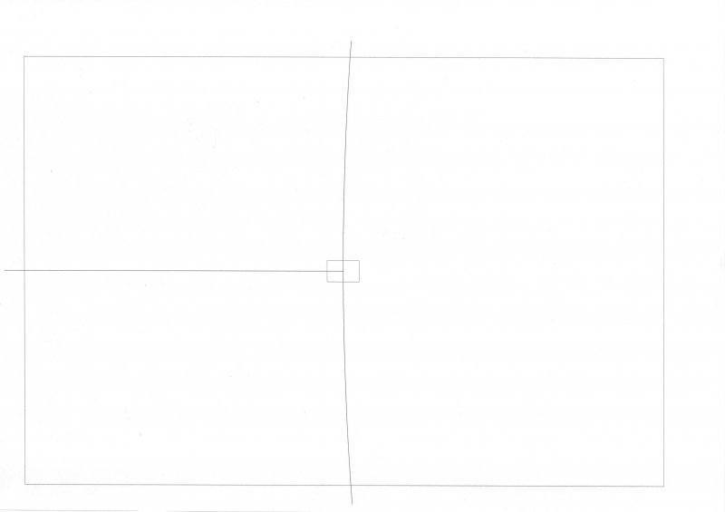

Using Autocad, I decided to draw the black hole and planet to scale, see attached drawings. In the first image, BH_1, the outer curves are the boundary of the ergosphere and the circle is the event horizon. The line at the equator represents the accretion disk. The small box at the junction between the accretion disk and the EH is 3.0e+7 by 2.0e+7 km and is represented in the second image BH_2. The smaller box in the centre of the image BH_2 is 1.5e+6 by 1.0e+6 km and is represented in BH_3. In BH_3, you can just make out the planet at the centre of the image (I've used a 10,000 kmm dia for the planet). This demonstrates just how close to the EH the planet needs to be to get that kind of time dilation.
