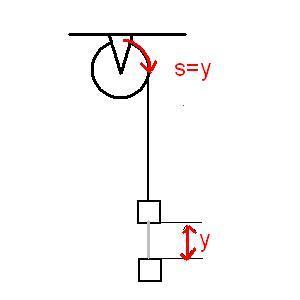

  1. A light string is wrapped around a solid cylinder and a 300 g mass hangs from the free end of the string, as shown. When released, the mass falls a distance 54 cm in 3.0 s.
    a. Draw free-body diagrams for the block and the cylinder. b. Calculate the tension in the string.
    c. Calculate the mass of the cylinder

You need to know how the linear acceleration a and the angular acceleration α are related.
When the hanging box travels y distance, the length of the hanging part of the rope increases by y. That length s=y has to be unwrapped from the cylinder, so as it turns by the angle θ=s/r.
Accordingly, the velocity of the rim is v=rω and you get the the analogous relation between the acceleration a and angular acceleration α.

Ah okay, I see what you mean. So, the distance traveled by the block has to = the distance traveled in radians around the cylinder (which is θ = L/r, the length between θo and θ divided by the radius)? Does this mean I should figure out a way to incorporate equations about the block's movement and equations about the cylinder's movement, since they are directly related? (Sorry, in addition to being poor at math, I'm just trying to understand conceptually what is happening as well!)
If this is the case, is it very important which equations about the motion I should be using, or does it not matter since the motion of the block and cylinder are related in multiple ways?

I like this equation you've found. It was exactly the right thing to do. Although you should have brackets round ##(r^2 \alpha)##.
All you need to do is calculate ##a## calculate ##\alpha## (which is related to a), plug them in and you have a nice formulaic answer. You don't need to start calculating angular velocity or rotational energy. You were very close with that equation.

How is this? If α = a/r, I can use that to plug into α in the equation?
if so, I THINK I have it:
2rm(g-a) / (r^2 * α) = M
2rm(g-a) / (r^2 * [a/r]) = M
which becomes
2r^2m(g-a) / (r^2 * a) = M
and cancel out the r^2
2m(g-a) / a = M
M = 484kg
Although that number seems way too large for the context of the question..
EDIT: My bad, I put in m = 3.0kg instead of 0.3.
M = 48.4 kg
Looks about right.
