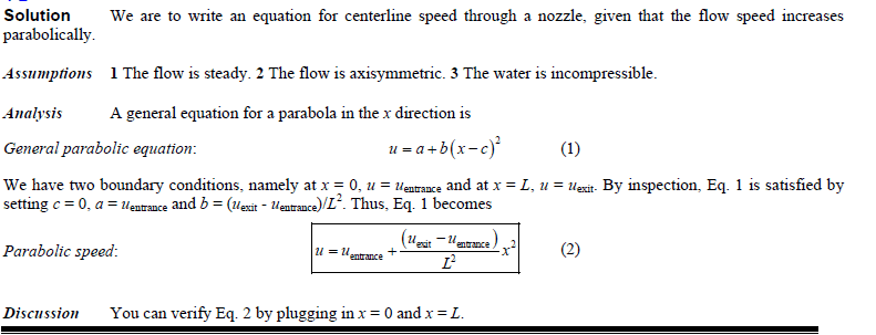

u=a+ b(x-c)^2
We have two boundary conditions at x=0, u=u(entrance) and x=L, u=u(exit)
Source: Fluid Mechanics by Çengel/Cimbala
I cannot understand the parabolic equation in the x-direction.
This is the original solution but it is still hard to understand for me. First I cannot understand general parabolic equation as 1 and why is cet set to 0, a=uentrance and b=(uexit-uentrance)/L^2.
Would you like to explain them?
Thank you.

Did you set x = 0? What speed did you obtain?
Did you set x = L? What speed did you obtain there?
What about some intermediate location, say x = L/2? What is the speed there?
for x=0, u=a+b*(0-c)^2, u=a+b*(c^2)
for x=L, u=a+b*(L-c)^2, u=a+b*(L^2 -2Lc + c^2)
for x=L/2, u=a+b*(L/2 - c)^2, u=a+ b*(L^2 /4 - Lc +c^2)
No, you use Eq. (2) and make the substitutions there. Eq. (1) is just a generic parabola.
