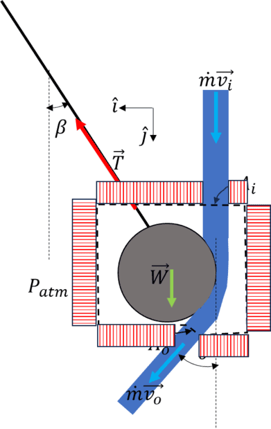

In x-coordinate direction,
$$ T\sin(\beta )=\dot{m}v_{0}\sin(\theta))$$
$$\dot{m}=\frac{T\sin(\beta )}{v_{0}\sin(\theta)}\rightarrow (1)$$
In y-coordinate direction ,
$$T\cos(\beta )-W=-\dot{m}v_{0}\cos(\theta))-(-mv_{i})$$
$$T\cos(\beta )-W=\dot{m}(v_{i}-v_{0}\cos(\theta))$$
$$\dot{m}=\frac{T\cos(\beta )-W}{v_{i}-v_{0}\cos(\theta)}\rightarrow (2)$$
$$(1)=(2)$$
$$\therefore \frac{T\sin(\beta )}{v_{0}\sin(\theta)}=\frac{T\cos(\beta )-W}{v_{i}-v_{0}\cos(\theta)}$$

You aren't getting what I'm saying ( or I don't understand what making ##\dot m## "the subject " is). Either way, you want each equation to not have any velocity parameters. Just the force terms, mass flowrate ##\dot m ##, relevant area ##A_i,A_o##, and known physical properties (density). Don't join the equations yet.
Think about equating ## \dot m = \dot m_i = \dot m_o ## to eliminate each velocity ## v_i,v_o## from each equation.

ohh so I need to put ##v_{o}## and ##v_{i}## in terms of ##\dot{m} ##,##\rho## and ##A## using ##\dot{m}=\rho vA##
  • #74
yeah for each location ( inlet/outlet) that holds.
$$ T\sin(\beta )=\dot{m}v_{o}\sin(\theta))\rightarrow (1)$$
$$\dot{m}=\rho v_{o}A_{o}$$
$$v_{o}=\frac{\dot{m}}{\rho A_{o}}\rightarrow (2)$$
Substitute (2) into (1) :
$$T\sin(\beta )=\dot{m}(\frac{\dot{m}}{\rho A_{o}})\sin(\theta)$$
$$\therefore T\sin(\beta )=\frac{\dot{m}^{2}\sin(\theta)}{\rho A_{o}}$$
$$T\cos(\beta )-W=-\dot{m}v_{o}\cos(\theta))+mv_{i}\rightarrow (3)$$
$$v_{i}=\frac{\dot{m}}{\rho A_{i}}\rightarrow (4)$$
Substitute (2) and (4) into (3):
$$T\cos(\beta )-W=-\dot{m}\frac{\dot{m}}{\rho A_{o}}\cos(\theta)+m\frac{\dot{m}}{\rho A_{i}}$$
$$\therefore T\cos(\beta )-W=\frac{\dot{m}^{2}}{\rho A_{i}}-\frac{\dot{m}^{2}\cos(\theta)}{\rho A_{o}}$$

Keep factoring the y coordinate equation to clean it up. Otherwise, ok. Then keep going.

Your algebra looks unnecessarily complicated here. Just use the x direction equation to eliminate ##T## in the y direction.
$$T\sin(\beta )=\frac{\dot{m}^{2}\sin(\theta)}{\rho A_{o}}$$
$$T=\frac{\dot{m}^{2}\sin(\theta)}{\rho A_{o}\sin(\beta )}\rightarrow (5)$$
In y-coordinate direction,
$$T\cos(\beta )-W=\frac{\dot{m}^{2}}{\rho A_{i}}-\frac{\dot{m}^{2}\cos(\theta)}{\rho A_{o}}\rightarrow (6)$$
Substitute (5) into (6),
$$\frac{\dot{m}^{2}\sin(\theta)\cos(\beta )}{\rho A_{o}\sin(\beta )}-W=\frac{\dot{m}^{2}}{\rho A_{i}}-\frac{\dot{m}^{2}\cos(\theta)}{\rho A_{o}}$$
$$\frac{\dot{m}^{2}\sin(\theta)}{\rho A_{o}\tan(\beta )}-W=\frac{\dot{m}^{2}}{\rho A_{i}}-\frac{\dot{m}^{2}\cos(\theta)}{\rho A_{o}}$$
  • #86
printereater said:
$$T\sin(\beta )=\frac{\dot{m}^{2}\sin(\theta)}{\rho A_{o}})$$
factor the RHS a bit more and then proceed to solve for ##\beta##, and you are done with that part.
$$\frac{\dot{m}^{2}\sin(\theta)}{\rho A_{o}\tan(\beta )}-W=\frac{\dot{m}^{2}}{\rho}(\frac{1}{ A_{i}}-\frac{\cos(\theta)}{ A_{o}})$$
$$\frac{\dot{m}^{2}\sin(\theta)}{\rho A_{o}\tan(\beta )}=\frac{\dot{m}^{2}}{\rho}(\frac{1}{ A_{i}}-\frac{\cos(\theta)}{ A_{o}})+W$$
$$\frac{\rho A_{o}\tan(\beta )}{\dot{m}^{2}\sin(\theta)}=\frac{\rho}{\dot{m}^{2}}( A_{i}-\frac{A_{o}}{ \cos(\theta)})+\frac{1}{W}$$
$$\tan(\beta )=\frac{\rho\dot{m}^{2}\sin(\theta)}{\dot{m}^{2}\rho A_{o}}( A_{i}-\frac{A_{o}}{ \cos(\theta)})+\frac{\dot{m}^{2}\sin(\theta)}{\rho A_{o}W}$$
$$\tan(\beta )=\frac{\sin(\theta)}{A_{o}}( A_{i}-\frac{A_{o}}{ \cos(\theta)})+\frac{\dot{m}^{2}\sin(\theta)}{\rho A_{o}W}$$
\tan(\beta )=\arctan[\frac{\sin(\theta)}{A_{o}}( A_{i}-\frac{A_{o}}{ \cos(\theta)})+\frac{\dot{m}^{2}\sin(\theta)}{\rho A_{o}W}]$$

You go off the rails on the next step. In general, ##\frac{1}{a+b} \neq \frac{1}{a}+\frac{1}{b} ##.

You are trying to solve for ##\beta## as a function of all the other variables you intend to measure. If that’s is what “making it the subject is “, then sure. You made an algebraic mistake when inverting both sides.
$$\frac{\dot{m}^{2}\sin(\theta)}{\rho A_{o}\tan(\beta )}-W=\frac{\dot{m}^{2}}{\rho }(\frac{1}{A_{i}}-\frac{\cos(\theta)}{\ A_{o}})$$
$$\frac{\dot{m}^{2}\sin(\theta)}{\rho A_{o}\tan(\beta )}=\frac{\dot{m}^{2}}{\rho }(\frac{1}{A_{i}}-\frac{\cos(\theta)}{\ A_{o}})+W$$
$$\frac{\dot{m}^{2}\sin(\theta)}{\tan(\beta )}=\frac{\dot{m}^{2}\rho A_{o}}{\rho }(\frac{1}{A_{i}}-\frac{\cos(\theta)}{\ A_{o}})+W\rho A_{o}$$
$$\frac{1}{\tan(\beta )}=\frac{\dot{m}^{2}\rho A_{o}}{\dot{m}^{2}\rho\sin(\theta) }(\frac{1}{A_{i}}-\frac{\cos(\theta)}{\ A_{o}})+\frac{W\rho A_{o}}{\dot{m}^{2}\sin(\theta)}$$
$$\tan(\beta )=\frac{1}{\frac{\ A_{o}}{\sin(\theta) }(\frac{1}{A_{i}}-\frac{\cos(\theta)}{\ A_{o}})+\frac{W\rho A_{o}}{\dot{m}^{2}\sin(\theta)}}$$
$$\beta =\arctan[\frac{1}{\frac{\ A_{o}}{\sin(\theta) }(\frac{1}{A_{i}}-\frac{\cos(\theta)}{\ A_{o}})+\frac{W\rho A_{o}}{\dot{m}^{2}\sin(\theta)}}]$$ I am not sure if there is a nicer way to express ##\beta##
  • #93
Its good enough for now. Do you understand how to use it?

## \beta## is the steady state angle, you need all the other variables measured (or controlled) and the equation spits out the angle the string makes with vertical (getting how far it moved is just trig), you can determine how well that fits with the angle ##\beta_{exp}## you experimentally measure. There is going to be error in all the variables to account for etc...
  • #96
erobz said:
## \beta## is the steady state angle, you need all the other variables measured (or controlled) and the equation spits out the angle the string makes with vertical (getting how far it moved is just trig), you can determine how well that fits with the angle you measure. There is going to be error in all the variables to account for etc...
I need to plot a graph using the 2 variables though (Flow rate and distance moved by the sphere). If I use this formula, the distance moved by the sphere can be expressed this way, ##\tan(\beta ) =\frac{D}{L} \therefore D={L}\tan(\beta )##, where D is the distance moved by the sphere and L is the length of the string. If I plot this function, I will be showing a relationship between ##\beta## and D. ##\beta## has 2 variables that are changing constantly ##\theta## and ##\dot{m}##. Is there a way to overcome this and show the relationship between ##\dot{m}## and D without the ##\theta##
  • #97
Yes! Can you guide me through the calculations of uncertainties too please
  • #98
I just realised, there are 4 variables that are changing each time based on the flow rate of water ##\ A_{o},\ A_{i}, \theta, \dot{m}##. So I have no choice but to plot D against ##\beta## right
  • #99
This is the steady state solution. ##\dot m ## must be controlled. The idea is that if you control the flowrate to be constant, all other experimentally measured variables ##\theta, A_i,A_o## are constant too (for each flowrate). So, the equation predicts the angle of the string ##\beta##. Then, you change the flow rate(but keep it steady), and re-measure the variables, and again the equation predicts the angle. You compare how well the equation matches what you experimentally measure for ##\beta## at each flowrate.
The goal is to see how well our theory about reality, matches reality. Will it be a decent model given our assumptions, and our inability to precisely measure the variables that contrive it? That is the purpose of an experiment.
Likes printereater
  • #100
Right, I get what you mean but for the graph I plot, am I going to plot ##\beta## against ##\dot{m}## or do I just plot ##D=L\tan (\beta )## to show the relationship between flowrate of water and sphere. With this formula I can show how ##\beta## changes with D to indirectly show the relationship between flowrate and D because what's affecting ##\beta## is ##\dot{m}## but I am wondering if there is a direct way to show the relationship flowrate and D.
  • #101
Just do this. you are introducing more sources of error by adding new variables that need measured.
Do you mean without measuring ##\theta, A_i, A_o##?
  • #102
But then i would not be answering my research question though:(
I mean ideally I would love to have an equation in which I have D on the left hand side and ##\dot{m}## on the right hand side to directly express a relationship between these 2 variables.
  • #103
A closed form solution of ##\beta( \dot m )##...for all I know that could be a Nobel Prize in Physics.
  • #104
oh😂 Let's not go there then
  • #105
By all means, give it shot if you are unsatisfied.
