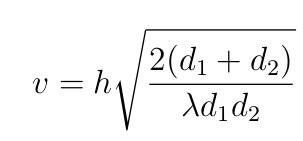

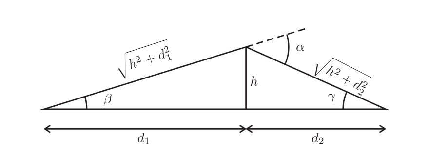

Knife-edge diffraction bleeds a small amount of energy passing a knife edge into the shadow zone. The energy affected is only that which passes a few wavelengths from the knife edge. The wavelength of light is extremely small compared with the size of a gnomon, or a building, so the proportion of light diffracted is minuscule.
The Sun produces a very wide spectrum of light. Knife edge diffraction will really only be visible for monochromatic light passing within a few wavelengths of a sharp edge.

That's like asking, if the sun were a point source, what would be the maximum accuracy of the sundial once all other factors like analemma etc were corrected for?
Jonathan212 said:
We have the numbers for sun diameter etc which translate into an angle and the angle translates into 2 minutes of time precision. What are the numbers for the effect due to the wave nature and wavelength of light?
The wavelength of light is so short, and the spectrum so wide, that it has no effect on the accuracy of a sundial. You can improve the accuracy by replacing the plate gnomon with a cylindrical style, and replacing the flat plate with part of a graduated cylinder about the style axis. If the diameter of the style is selected to be 0.5° when viewed from the scale, the shadow of the style will not be asymmetric but will have the mid-line darkest, with light either side. That will improve the resolution by a factor of 4 or more. It would cancel edge diffraction effects, if they were visible, but it cannot reduce the horizon refraction in the few minutes after dawn or before dusk.
Jonathan212 said:
Wow! That angle is big.
That angle will be 90°, but it effects only a thin skin about one micron thick, and then only if the edge is optically straight, and a perfect conductor. Illumination falling in the shadow will be less than 0.1% of that of the sunlit area, so you will not notice it.
No it won't be 0.1%, it'll be 0.01% at 120 degrees. Without sources to back them up, such numbers are not appreciated.

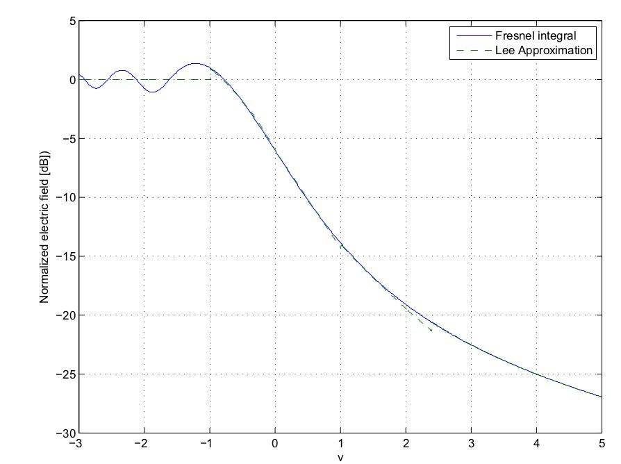

I got the 0.1% from a conservative -60dB on a diffraction chart.
Where did you get your 0.01% ?
The 0.01% is arbitrary of course, and so is the 120 angle measured from the plane of the knife. Where is the diffraction chart?
The light is diffracted as it crosses the knife edge. The light is initially at 90 degrees to the plane of the knife. It then turns to fill the shadow behind the knife. If you measure the angle relative to the plane of the knife the direction becomes 0° or 180°, not 120°. The light still only changes direction by 90° on passing the edge.
“Electronic Transmission Technology; lines, waves and antennas”. By William Sinnema. 1979. Chapter 8.
Where is the -3 dB or -6 dB point in that diffraction chart in the Sinnema book?
Stating the obvious once again, those 0.01% and 120 figures are just fake figures made up to help you feel how people might feel when unsubstantiated figures are thrown at them by a stranger online - trying to prove them wrong is missing the point, the point is your figures need backing. Ideally online but that book is ok too, sort of, as long as you're honest. Fully shadowed in the context of the conversation means no straight light from the sun but even with all diffractions taken into account the image processing would be trivial: just fit an expected parametric curve to pixel values along a line in a photograph of the sundial. But we must stay low tech like the eye or it's pointless. Maybe lenses too.

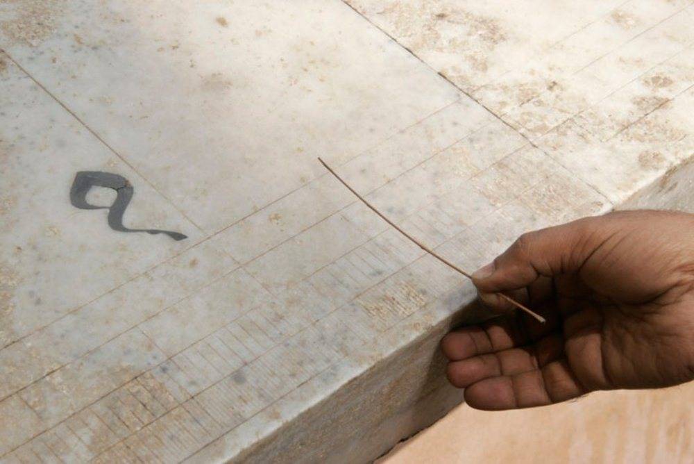

Marcusl, I can΄t find how that big Indian sundial achieves 2 second accuracy. This contradicts calculations by people above, any idea how it might be done?
As low tech as it gets...
It says where the twig's shadow disappears, that's what the time is (marks are every 2 seconds). And you then correct for analemma with a calculator? :smile: But the big shadow is much sharper than the 2 minutes of width expected based on the diameter of the sun.

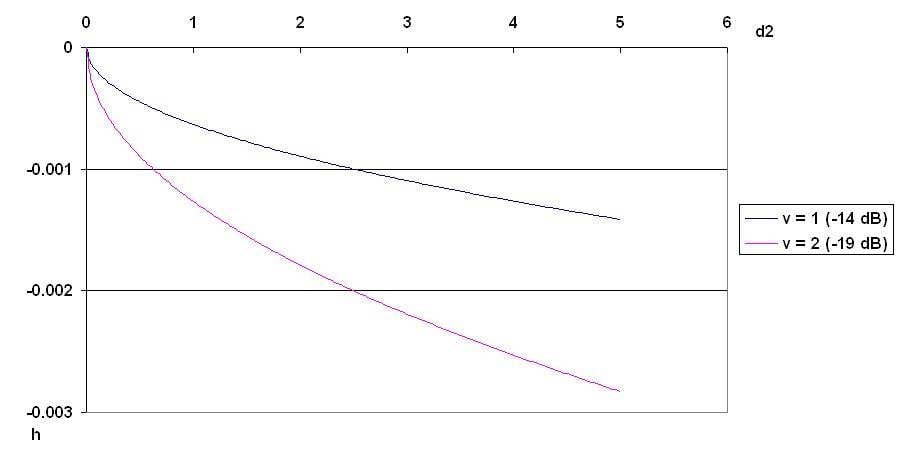

A partially occluded sun would have a visible area like this:
Source: http://mathworld.wolfram.com/CircularSegment.html
Therefore the plot of light from fully shadowed to fully lit should look like this:
Let's add the diffraction chart on top. Where does -3 dB or -6 dB fall?
