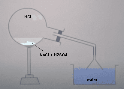

If you add 1 g of water to 1 l of hydrogen chloride, would hydrogen chloride be spilt from the bottle, or would air be sucked in?
I've not done that. But when dissolving hydrogen chloride in water, we used an inverted funnel to avoid the water being sucked back into the HCl generator.
So I'd expect air to be sucked in.
You can see water being sucked in when some is added to a flask containing some HCl. This is the HCl fountain experiment

Scroll up at the post where hydrogen chloride generator is used to feed a funnel... there filled with NaCl/H2SO4 mixture, and heated.
Well, you can use the same arrangement to generate gaseous hydrogen chloride by heating hydrochloric acid above 20 %! Say, 32 % acid would give off mostly HCl and little water Thus you can distil one portion of 32 % acid down to 30 % and absorb the fumes into the other portion of 32 % acid which you are cooling. So you can get from two portions of 32 % acid a portion of 30 % and a portion of 34 % acid. Or if the portions are different size and you are using enough cooling of the second portion, as much as 48 % acid.
