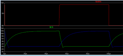

  • #48
MagneticMagic said:
Here's 10kHz. The upper is the PWM drive source, the lower shows the two coils. dB/dt is magnitudes higher than sine wave.
Can you please let us have a copy of your file.asc used for the simulation in post #33.
Change or add a .txt suffix to the file.asc to make it file.asc.txt so you can attach it to a post.

  • #52
artis said:
So far it seems your just happy to calculate the power through the coil but calculate the power into the actual material when it's inserted.
As a transformer with a centre-tapped Cu primary and a single turn resistive Pb secondary, the driver magnetising current will be VAR while the shorted turn will be real VA power. The relative magnitude of those two driver current components will be interesting. I am waiting for the LTspice model.
What are the resistivities of solid and molten lead ?

  • #61
artis said:
You need to look at the energy put in over time.
I did exactly that.
dB/dt * time = some J
Look at B in cos function
There are 4 distinct quadrants (that last gify shows it)
0-90deg (Bmax to zero)
90-180 (zero to Bmax)
180-270 (Bmax to zero)
270-360 (zero to Bmax)
The zero point is where dB/dt is max, as shown in that last gify.
I evaluated only the 0-90deg in my math above.
0-90 has a dB/dt, or J value from eddy (in my example, J per 25usec)
The overall J in eddy per full one cycle of frequency is the 0-90 J * 4
The push-pull in DC is technically AC.
To get same Bmax you need 100A DC, or 70.7A ACRMS
My math should be correct.
