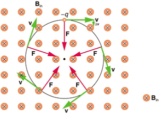

I’ve read and thought a little more about this question, and I think the question can be strengthened somewhat. However, I think it ultimately can be resolved. Please bear with me.
I came across the following chapter which explains the history: https://link.springer.com/chapter/10.1007/978-1-349-11139-8_6
As a quick digest of the chapter, Faraday and Ampere disagreed about two main issues:
a) Ampere conceived of magnetism in terms of Newtonian forces acting at-a-distance, while Faraday thought in terms of fields.
b) To Ampere, the attractive/repulsive forces between two current carrying wires was the fundamental fact about magnetism, and could explain all other magnetic phenomena. He believed that all magnetic phenomena were caused by miniature electric currents that existed inside magnetic materials. He struggled to find a model that was consistent with experiment, and so Faraday rejected his view.
Faraday’s field view (issue 1) prevailed. Regarding issue (2), it seems that Ampere’s view prevailed to a certain extent, as we now explain the properties of magnetic material as result of the motion of the electrons inside their constituent atoms. This latter point seems to strengthen my original question. Faraday, given the scientific knowledge at the time, would not have developed the concept of magnetic fields by looking at the force on a test electric current (or moving charge) in the presence of a source electric current (or moving charge). He had no reason to see currents as the fundamental fact of magnetism, and therefore constructed the concept of magnetic field by looking at the force on iron filings. However, that is merely a historical artefact, since today we know that the motion of charge within a material is what makes gives it its magnetic properties. If Faraday were to construct the concept of magnetic fields today, he may have based it on the forces between currents.
Now, here’s where I think why it wouldn’t work.
In a uniform magnetic field, a moving charge experiences a force which causes it to move in a circular path.
(taken from https://openstax.org/books/college-...in-a-magnetic-field-examples-and-applications)
A magnetic field constructed from the force between currents would not be able to produce such a force (as far as I can tell).
Thoughts?
Are you saying that you can't follow our math, but you're sure we're wrong?
Are you sure that's the path you want to go down?
Likes berkeman
Not at all!
All I was trying to say is:
a) There seems to be a historical motivation for the suggestion in the OP
b) I don't see how Amperian forces between currents/moving charges could account for the circular path.
Maybe I worded post #26 too strongly (although I kept saying 'I think' and 'may'), but that's all I was trying to say.
One should note that Ampere hasn't had yet the full dynamical knowledge about electromagnetism. This came later with Maxwell's addition of the socalled "displacement current" making, unknowingly of course, electromagnetism the paradigmatic example for a relativsitic field theory. Ampere's (and Weber's) theoretical framework was based on the action-at-a-distance picture, which you get from assuming magnetostatics and neglect the displacement current and retardation effects.
Given that the electromagnetic field is operationally defined via the forces on charges and currents, one could think that it is just an auxilliary quantity which may be eliminated from the physical laws, leading to a description of systems of charges and currents with direct action-at-a-distance forces.
Let's do this for two currents in thin two wire loops (of arbitrary shape) at rest carrying somehow currents ##I_1## and ##I_2##. Let the closed curves describing the wires be ##C_1## and ##C_2##. Let's start from the modern field view, which simplifies the analysis considerably. There the idea is that ##C_1## leads to a magnetic field, which can be described (in the static approximation) by Biot-Savart's Law,
$$\vec{B}(\vec{x})=\mu_0 I_1 \int_{C_1} \mathrm{d} x_1 \times \frac{\vec{x}-\vec{x}_1}{4 \pi |\vec{x}-\vec{x}_1|^3}.$$
The total force on ##C_2## then is
$$\vec{F}=I_2 \int_{C_2} \mathrm{d} \vec{x}_2 \times \vec{B}(\vec{x}_2).$$
Plugging the above formula for ##\vec{B}## in this you get
$$\vec{F}=\frac{\mu_0 I_1 I_2}{4 \pi} \int_{C_2} \mathrm{d} \vec{x}_2 \times \int_{C_1} \mathrm{d} \vec{x}_1 \times \frac{\vec{x}_2-\vec{x}_1}{|\vec{x}_1-\vec{x}_2|^3}.$$
Here you have a form, where the magnetic field is eliminated at the prize of a complicated non-local law.
It's also possible to do something similar for the general case of the full electromagnetic theory with taking into account the full relativistic effects of retardation. The elimination of the electromagnetic field then leads to quite complicated non-local dynamical laws. A famous example is Feynman's and Wheelers "absorber theory". It's called absorber theory because you must use an reinterpretation of the field picture to make "causal sense" of the necessity to introduce "half retarded and half advanced Green's functions". The original idea was to eliminate the fields and then make a pure "particle quantum theory" for point particles out of it by somehow "quantizing" this non-local classical particle symmetry.
This, however, never worked out, and the key of electromagnetism in quantum theory (both non-relativsitic quantum mechanics of point particles in classically treated electromagnetic fields, the socalled semiclassical approximation, as well as the full relativistic quantum field theory , quantum electrodynamics) are to use the potentials and gauge invariance and staying with strictly local laws. From the modern point of view this lesson teaches us that the most fundamental description of Nature seems to be closer to a local field-theoretical point of view than a point-particle action-at-a-distance point of view.
