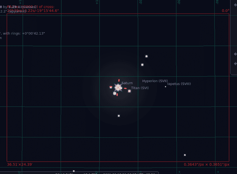

sophiecentaur said:
You can sort out stuff like exposure but there's nothing you can do about an image that's too big to fit or so small, it only occupies a dozen pixels. Stellarium is pretty magic for a free package, imo.
I checked my objective with my sensor on Stellarium, and it shows Saturn like a star, with those glare spikes and all which does not really show how much the actual image (disc) size is w.r.t the sensor outline. It does seem like the rings would be visible. This would appear properly on a DSLR when the exposure and gain are set properly. Now how do I measure what fraction of the sensor size / how many pixels the image is?
You can probably get rid of that simulated effect by just zooming in. But the point is made that Saturn is pretty small on your sensor. There is no solution to that, other than a better objective lens, a clearer atmosphere and a higher res sensor - at least twice the focal length of your present scope. But, as I have already commented, this is where you need to decide what subjects you want to look at - or which subjects are best suited to your scope.
Basically, your scope is very 'entry level' and no one would seriously try for astro images on such a scope - for a start, the mount doesn't appear to have tracking.
This leaves your problem reconciling what. you see with what the DSLR records. You have to compare like with like and it's easy to zoom in with photoshop and reveal things that you would never see in the EP. Your brain is making a good job of finding features in the EP image that are 'only just there'. That's been happening for centuries - for example the Martian Canals which you can see on early sketch maps of Mars. For a while, everyone could see them because they expected to find them.
You will get more satisfaction with your scope looking at groups and clusters of stars. Resolving double stars is good sport and so is spotting features in the Orion Nebula. When you have become expert enough in that part of astronomy and you can stand the expense (several hundred quid), then do your homework and choose appropriate gear.
I will also lose track of the sensor outline. I can actually see the planet's rings when the sensor outline is pretty much my PC screen, which means if I digitally zoom into full screen on my PC I should be able to see the rings - provided it has been recorded with a good number of pixels in that area. Which is not guaranteed.

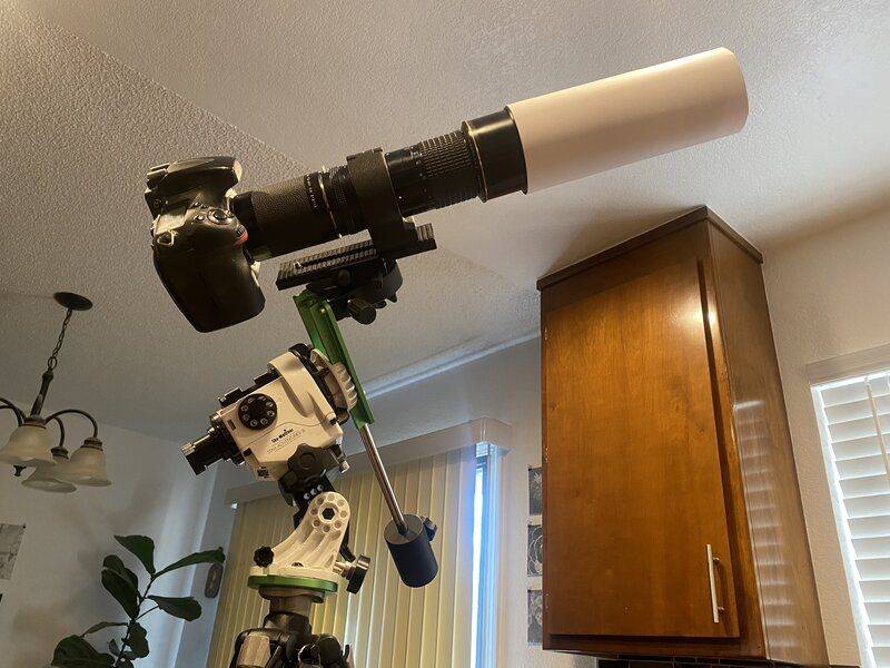

this was the rig I used, but the equatorial mount / tracker was turned off…

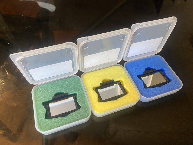

My next upgrade will be because I want to image in the narrowband Hubble palette, but I don’t want it to take multiple evenings of imaging… It’s hard enough to find a clear night with no moon, and takes enough time to get to my bortle 2 location, the thought of having to do that 3 or more times for 1 image is disheartening… and I already have the Hydrogen, Oxygen and Sulphur clip in filters for my DSLR, so what I plan to do is buy 2 more DSLR bodies, 2 more 300mm lenses and 2 more 2x teleconverters and 2 more trackers and then I’ll be able to image through all 3 narrowband filters simultaneously… Each exposure through these filters is often 5 minutes long even with very high ISO sensitivity settings, and I’m expected to take 20-40 or more of these through each filter and manually re-acquire the target each time… no thank you, I’d rather have 3 cameras. Switching between filters would be such a hassle as it often takes me 30-45 minutes just to focus the camera and then get it pointed in the right direction.

Heard that long exposures have less bias / read-out noise compared to sub-exposures. And, for the reason Devin-M mentioned, making full use of one perfect night / travel means I should be taking in as much signal and less noise as possible, which is possible with tracking (at least manual, nightmare in an alt-az mount).
@Devin-M, does the use of NB filters increase the exposure time needed since you will be receiving less photons per second than ideal?

I also learned today about how pixel size on the sensor affects my image. It turns out that I need bigger pixels to collect more light from faint objects (DSO) and smaller pixels if I need more detail out of small but bright objects (SSO). This makes me think, a DSLR with moderate pixel size at prime focus is really not very good for planetary, better stick to DSO's and build my gear around it. Those dedicated planetary cams seem to have tiny pixels that can pickup details with small area since the photons are abundant from an SSO.

The 300mm lens is f/4.5 & adding a 2x teleconverter makes it 600mm f/9.
My goal is to get full Hubble palette data on a target in a single night.
With 1 camera we’re talking 30-45 minutes setup. Each exposure is in the neighborhood of 5 minutes so if I want 60 images to stack from 1 narrowband filter we’re talking 5 hours or 6 hours including camera setup. Multiply 6 hours times 3 filters and we’re talking 18 hours which is obviously too long for 1 night of imaging… & honestly I start getting pretty bored and tired after only around 3 hours.
But if I have 3 cameras going simultaneously, I could get 15 hours of data in only 5 hours, for example, which is doable in a single evening.
If I were to have to find 3 separate nights with appropriate moon/weather that also fit my will/determination and schedule it could take weeks or months.
So I’d basically be spending around $500x2 for the dslr bodies, $500x2 for the trackers, maybe $500x2 for the lenses + teleconverters, so I’m basically looking at spending around $3k in order speed up the process of acquiring a single Hubble palette image from weeks or months to a single eve.
Alternatively I could capture 3 targets in the time it currently takes to capture 1 target.
Three cameras on a single mount would require an expensive mount. I could get 2 more trackers for about $1k ($500 each) but I am already basically pushing the weight limit for a single tracker.
