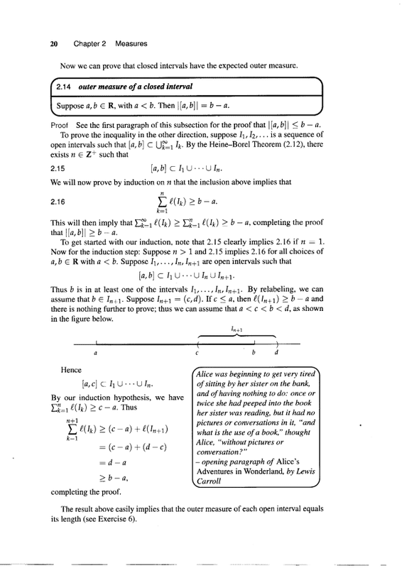

I am reading Sheldon Axler's book: Measure, Integration & Real Analysis ... and I am focused on Chapter 2: Measures ...
I need help with the proof of Result 2.14 ...
Result 2.14 and its proof read as follows:
In the above proof by Axler we read the following:
" ... ... We will now prove by induction on n that the inclusion above implies that ## \sum_{ k = 1 }^n l(I_k) \ \geq b - a##This will then imply that ##\sum_{ k = 1 }^{ \infty } l(I_k) \geq \sum_{ k = 1 }^n l(I_k) \ \geq b - a##, completing the proof that ##\mid [a, b] \mid \ \geq b - a##. ... ... "Can someone please explain exactly why ##\sum_{ k = 1 }^{ \infty } l(I_k) \ \geq \sum_{ k = 1 }^n l(I_k) \ \geq b - a## completes the proof that ##\mid [a, b] \mid \ \geq b - a##. ... ...
Indeed ... can someone please show, formally and rigorously, that ##\sum_{ k = 1 }^{ \infty } l(I_k) \ \geq \sum_{ k = 1 }^n l(I_k) \ \geq b - a## implies that ##\mid [a, b] \mid \geq b - a##. ... ...
Help will be much appreciated ... ...

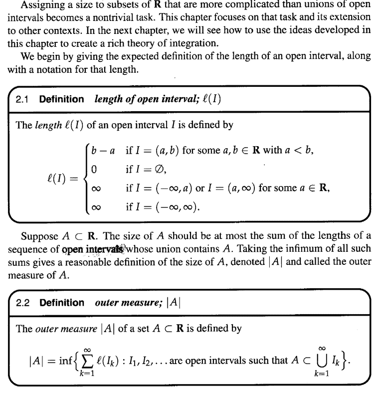

Readers of the above post may be assisted by access to Axler's definition of the length of an open interval and his definition of outer measure ... so I am providing access to the relevant text ... as follows:
Hope that helps ...
Peter
The author uses the following fact: Let ##A## be a non-empty set and ##b## be a fixed number. If ##a \geq b## for all ##a \in A##, then ##\inf(A) \geq b## (immediate from the definition of infinum: ##b## is a lower bound of ##A##).
In your case, the author shows ##b-a \leq |[a,b]|## by showing that ##b-a \leq \sum_k l(I_k)## for all choices of ##I_k## as in the definition of outer measure.
