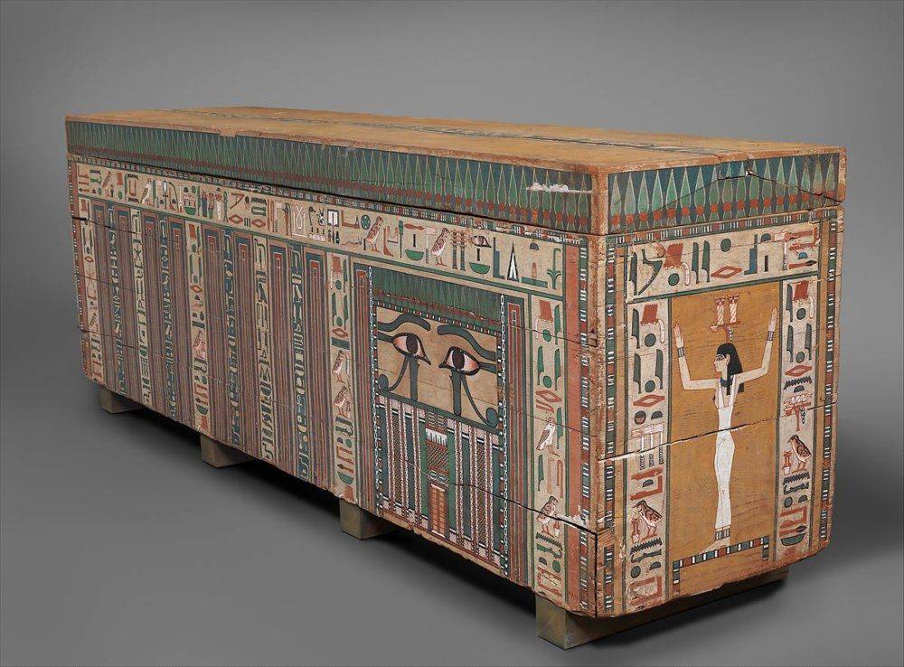

Casein (milk & lime == milk paint) painted designs on Egyptian furniture from the Middle Kingdom - 3500 years ago, are still in decent shape. I think natron (Sodium carbonate decahydrate) was used as the liming agent.
From metmuseum.org:
Likes BillTre, Klystron and hutchphd
