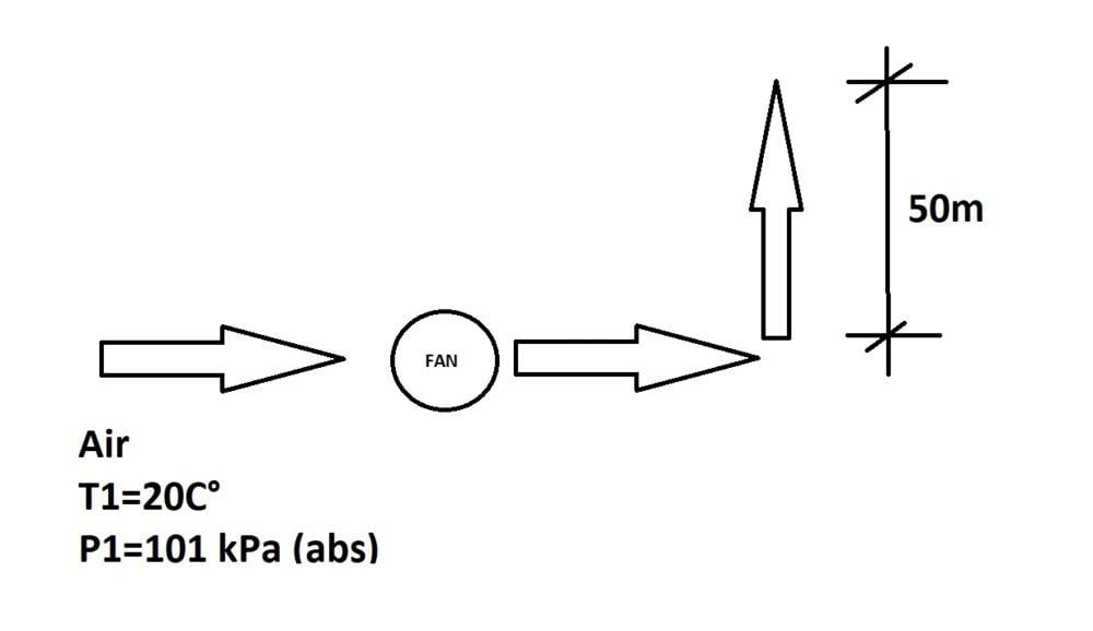

Applying Bernoulli, Does the term ρ*g*h matters ? I am trying to select a fan
I don't really understand what you're trying to do here - could you provide some more details? What do you need the fan to do, and what does the 50m mean in your diagram?
Are you trying to push the air 50 meters high or to the left?
I am trying to extract air from some bathrooms and discharge it on the roof,
I need to select a fan (working point implies a pressure resistance and a flow), I know the flow, but should I consider the column of air in this selection?
You could also reference the Gas Laws.
High, the horizontal trajectory is minimum, It is negligible in this case.

Short answer is "no". Yes, you have to push the air upward against gravity. But there is also a pressure gradient in the ambient atmosphere, lower pressure up high, higher pressure down low. The pre-existing pressure gradient exactly cancels the energy it would take to force your exhaust air up through the pipe against gravity.
Assuming your exhaust air is the same density as the ambient atmosphere.
Likes Emanuel Silva, cjl, gmax137 and 1 other person
As jbriggs said, the pressure gradient in your column is matched by the atmosphere, so no you will not need to consider it. However, in a 50m pipe, it's likely that viscosity is not negligible, so you won't just be able to directly use bernoulli here if you need an accurate estimate of the flow that the fan will provide.
Likes Emanuel Silva and jbriggs444

It goes back to Archimedes and buoyancy. Air is neutrally buoyant in air.
Same as water is neutrally buoyant in water. It takes arbitrarily little pressure to circulate water as long as you are willing to circulate it arbitrarily slowly. The underlying explanation for buoyancy is the variation of pressure with depth. Pascal's principle.
Edit: As @cjl has noted, viscosity will resist flow based on the pipe length even though gravity may not. For laminar flow, for instance, see this link.
Likes Emanuel Silva

If you are going to use Bernoulli, even with a viscous term included, you need to include the gravitational (potential energy) term. However, it may not be too important.
I don't "disbelieve you" but doesn't the Potential Energy of the falling air outside cancel that out? You are normally pretty good on fluids so I hesitated to ask.
I don't understand your term "falling air outside." My understanding is that the air outside the pipe is static. So there is a gravitation induced gradient of pressure in the outside air. This will turn out to just cancel the gravitation potential energy term in the Bernoulli equation for the air inside the pipe. But, in applying the Bernoulli equation to the air inside the pipe, the gravitational potential energy term should be included, and then be canceled with the outside air term later. It is true that, if the gravitation contribution to the pressure is neglected in both the air inside the pipe and the air outside, the final answer will come out correct.

PE gained inside equals PE lost on the outside - is all. And your post agrees with that.
