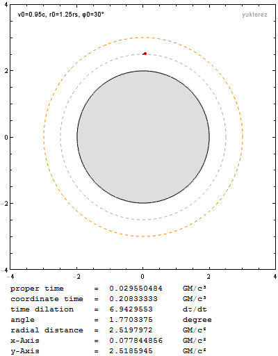

Now the question is, how do I choose my initial conditions for the angular and the radial initial velocities, for example, if I want to test the orbit of a test particle close to the speed of light [itex]v_0=0.999c[/itex] at the photon sphere [itex]r_0=1.5r_s[/itex]?
I am not sure if my approach is correct, but when I try
[tex]\dot{\theta}_0\cdot r_0 = \frac{\xi_0}{ \color{red}{\sqrt{ 1-v_0^2/c^2}}\cdot \color{blue}{\sqrt{1-r_s/r_0}}}[/tex]
with [itex]\xi_0[/itex] as the transversal component of [itex]v_0[/itex] and [itex]\kappa_0[/itex] as the radial component:
[tex]\dot{r}_0\ = \frac{\kappa_0\cdot \color{blue}{\sqrt{1-r_s/r_0}}}{ \color{red}{\sqrt{ 1-v_0^2/c^2}}}[/tex]
so that [itex]\xi = cos(\varphi_0), \kappa = sin(\varphi_0)[/itex] with [itex]\varphi[/itex] as the launching angle from the shell, the orbits look like I would expect them, at least in the transversal direction:
But since radial and transverse directions have the factor [itex]\color{blue}{\sqrt{1-r_s/r_0}}[/itex] on different sides of the fraction, the inital angle is not conserved.
So are my initial conditions even correct, and if not, how would one transform the radial and the transversal components of the initial velocity [itex]v_0[/itex] to [itex]\dot{r}(0)[/itex] and [itex]\dot{\varphi}(0)[/itex]?

If it is of interest, the code for the plot is in Mathematica Syntax
Code:
G = 1; M = 1; c = 1; rs = 2 G M/c^2; T = tMax G M/c^3;
r0 = 151/100 rs; vo = 999/1000 c; φ = Pi/2; θ0 = 0; tMax = 2;
vr0 = vo Cos[φ]/j*k; vθ0 = vo/r0 Sin[φ]/j/k;
d1 = T/10; d2 = d1; wp = 30; step = T/200;
j = Sqrt[1 - vo^2/c^2];
k = Sqrt[1 - rs/r0];

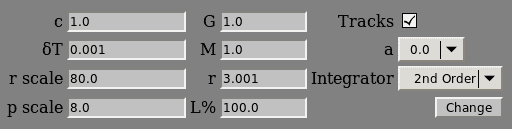

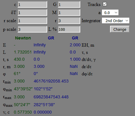

On further reflection it occurs that I might be able to help more with this, if you want to test out an orbit like the one you described. Let c = G = M = ##\mu## = 1. Then you should be able to get an orbit close to the photon sphere if you set:
a = 0.0
r = 3.001
E = 18.272630817366
L = 94.899952581663
You should get an unstable orbit where:
v = 0.999833 (##\gamma## = 54.781)
Hope that helps (I set this up on the JavaScript simulator, you can use it as an independent check for your stuff - or let me know if I've got something wrong!).
Likes edguy99

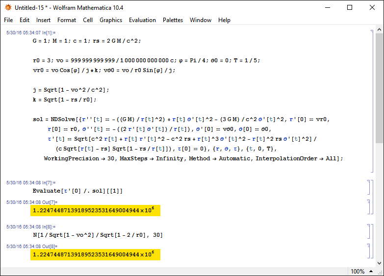

I came to the conclusion that the right way to transform the v₀ into the initial conditions for the equation of state, r'(0) and θ'(0), must be
[tex]\dot{\theta}(0)\cdot r(0) = \frac{{v\perp}_0}{ \color{red}{\sqrt{ 1-v_0^2/c^2}}}[/tex]
[tex]\dot{r}(0) = \frac{{v\parallel}_0\cdot \color{blue}{\sqrt{1-r_s/r_0}}}{ \color{red}{\sqrt{ 1-v_0^2/c^2}}}[/tex]
When I convert the initial velocity components by that factors I get the same time dilation with the differential
[tex]{\tau}'(t) = \frac{\sqrt{c^2\cdot r(t)-c^2\cdot r_s +r(t)\cdot r'(t)^2- r_s\cdot r(t)^2\cdot \theta '(t)^2+r(t)^3\cdot \theta '(t)^2}}{c\cdot \sqrt{r(t)- r_s } \cdot\sqrt{1-\frac{ r_s }{r(t)}}}[/tex]
as I get it with
[tex]\frac{1}{\sqrt{1-v_0^2/c^2}} \cdot \frac{1}{\sqrt{1-r_s/r_0}}[/tex]
see the test calculation where Out[7] matches Out[8]:

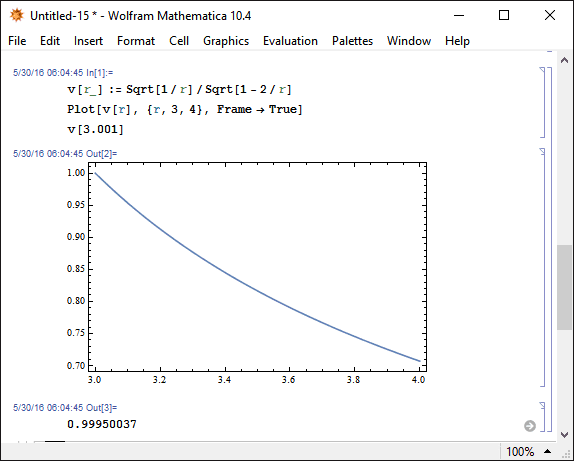

m4r35n357 said:
r = 3.001
v = 0.999833 (γ = 54.781)
How did you obtain that value? When I use the formula √(GM/r0)/√(1-rs/r0) I get v0 = 0.9995
I just logged on to post that I do not get

George Jones said:
This is what I get.
Very fine, then the first problem is solved, and only one question remains.
Because the blue gravitational factor is only in the radial direction it seems that angles are not preserved, for example, if someone throws a ball with 45° locally, the initial angle seems flatter for a coordinate observer at infinity (that's what I suspect)? Or do I have to split the components in a way that the angle is preserved (I don't think so)?
My guess is that if I want to switch from proper circumference to proper radial distance (since the factor is not 2π anymore in Schwarzschild coordinates) I'd have to do something like multiply the old r coordinate with rs+∫(1/√(1-rs/R), R=rs..r) on a Plot?
I don't see how the "potential" (blue) factor can produce a speed. I use the "kinetic" (red) factor:
##\gamma = \sqrt { \frac {1} {1 - v^2}} ##, so that
##v = \sqrt {1 - \frac {1 } { \gamma^2} }## (by ##v## I really mean ##v / c##!)
where ##\gamma = \frac {dt} {d\tau}## from the simulation to give me that value of ##v##.
Caveat:
We are using different methods to simulate and I must admit I don't fully understand your equations of motion. At first I thought they were the geodesic equations but I don't recognize the Christoffel symbols so now I'm not so sure.
Anyway, I think the ##t## in your equations is what I would refer to as ##\tau##, and ##\theta## is what I would refer to as ##\phi##. You would need to solve for ##t## (using another geodesic equation) and extract the intermediate ##\frac {dt} {d\tau}## in order to use my formula.
Are any of my assumptions mistaken?
This is what I think, too. Maybe Yukterez has a math background, Mathematicians and physicists tend to interchange the roles of ##\phi## and ##\theta## in spherical coordinates.
You're using ##\gamma## with respect to infinity, while Yukterez is using a ##\gamma## generated by a local physical velocity.
Suppose I stand on platform that uses a powerful rocket to keep it hovering constant ##r_0## and ##\theta## (i.e., ##\phi## for physics books). I then throw a ball that has initial speed ##v_0## (and that makes an initial angle ##\varphi## with respect to the platform). Then,
$$\gamma = \frac{1}{\sqrt{1 - v_0^2}} = \frac{dt}{d\tau} \sqrt{1 - \frac{2GM}{c^2 r_0}}.$$

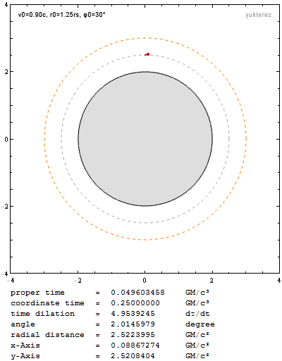

Here is the updated code (Mathematica Syntax), where θ is the longitude (the plane can always be rotated so that the lattitude is fixed), and φ the launching angle from the observers shell:
Code:
r0 = 151/100 rs; vo = 999/1000 c; φ = 0; θ0 = 0; tMax = 2; T = tMax G M/c^3;
vr0 = vo Sin[φ]/j*k; vθ0 = vo/r0 Cos[φ]/j;

In my equation of motion the latter is the case. That makes it very similar to Newtons equation, except the additional term - 3GM/c² θ'² in
r'' = -((G M)/r'²) + r θ'² - (3 G M)/c² θ'², θ''= -((2 r' θ')/r)
so I transform the initial velocity into the rapidity.
Then I differentiate coordinate time by proper time with
τ' = √[c² r + r r'² - c² rs + r³ θ'² - r² rs θ'²]/(c √[r - rs] √[1 - rs/r])
and finally get the positions at any given proper and coordinate time. From there I can easily transform into the system of any stationary shell observer at height R just by multiplying the coordinate time at infinity with √(1-rs/R).

I played around with your simulator and at least I found out how to input a circular orbit at the photon sphere:
This gives an orbital velocity in coordinate distances by coordinate time of v0=0.57735, so v0/√[1-rs/r0] with rs=2 and r0=3 is c locally. So far so good, this is not so hard to convert between our observers, just a factor of √[1-rs/r0] here and there. Now I just have to find out how to zoom in (if I set G=M=c=1 for easier numerics the plot gets really small) and give some initial radial velocity additional to the angular velocity. What parameter of yours is responsible for the radial velocity component, or alternatively the launching angle of the test particle?
What I also don't understand is why your E and L show infinity in this example when L<100%: Screenshot

As for the particle simulator, you can't go to 3.0 as it is a photon orbit. Try these settings to start with . . .
You can't do 3.0 because it's not a valid particle orbit, so the program is not working. You should be able to get quite close to 3.0 though.

Why not? For example, imagine a shell observer who is hovering at r0=2.5M=1.25rs. Now let him throw a particle at a launching angle of 30° with an initial velocity of v=0.9c (relative to himself in his own reference frame). This particle crashes into the black hole after approximately 5GM/c³ of its own proper time. Here the Plots by coordinate time of an observer at infinity where you can see the particle slow down when it approaches the horizon:
When I tell the observer to increase the initial velocity to v0=0.95c, the particle escapes to infinity:
So why shouldn't this be mathematically allowed? As long it is not at r0=rs or below, an observer can surely be a stationary shell observer, and he also can shine light and throw particles in any direction. What do you mean with "not allowed"?
