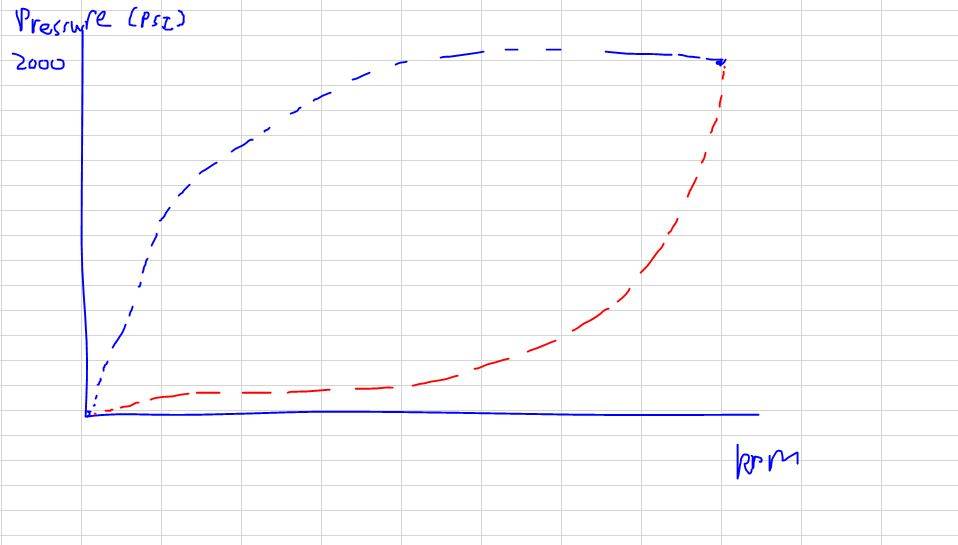

Okay, so I'm a bit confused now. If I go with a variable displacement vane pump, it seems like I can go with a variable displacement, pressure-compensated vane pump, or just a variable displacement vane pump right? But I originally thought a variable displacement pump would adjust it's flow rate based off downstream pressure and now it seems like that's the job for a variable displacement pressure compensated pump?

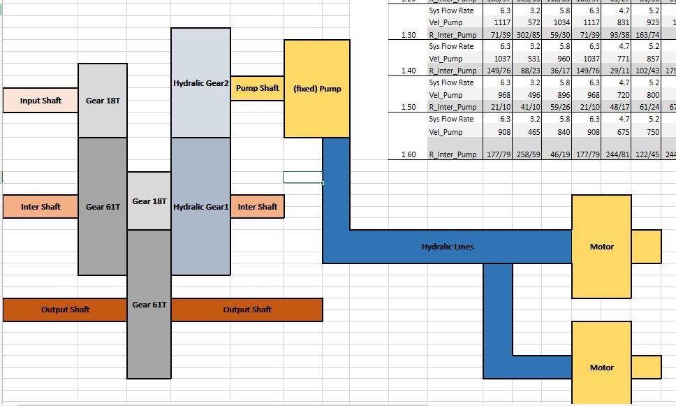

I may be wrong, but it seems to me that the synchrony of torque and rpm’s between front and rear axles may be a problem.
The rear axle receives power directly from the engine via roller chain #1 or belt: reduction #1.
The front axles receive power from the same engine via roller chain #2, pump and hydraulic motors: shouldn’t reduction #2 equal reduction #1?
If so, how could that synchrony be achieved?

The rear wheel drive is through a step ratio gearbox. So ratio depends on gear selected.
But the pump runs from lay-shaft in gearbox, so is proportional to gear independent engine RPM.
The variable geometry pump generates sufficient volume to maintain a set pressure. The pressure to the front motors is therefore controlled. With a set pressure applied to the two motors in parallel, the fixed displacement motors will generate a torque proportional to pressure, independent of road speed.
The front wheel torque can be set by adjusting the pump output pressure. The compensation for the different gear ratios is therefore automatic.
I know that you are busy now, Baluncore, but I would like you to explain this a little further whenever you have the time.
Doesn't the rpm's of the lay-shaft in gearbox depend on the rpm's of the engine?
(Could you @AielloJ clarify this point?)
The way I see it, perhaps incorrectly:
Torque supplied to each front tire will be limited by the normal force on the contact patch: too much and tires spin.
The rotational speed of that same tire will depend on the fixed ratio of displacement of pump and motor.
If that pump is directly linked (via fixed gearbox reduction) to the rpm's of the engine, the displaced flow will vary with it.
Wouldn't that fact induce a mismatch of tangential velocities among rear (modulated by gearbox) and front tires?
The engine turns the gearbox input shaft, which is geared with constant ratio to the lay-shaft and a pressure compensated hydraulic pump. So the volumetric pump ratio is NOT fixed.
The solution comes from the adjustable displacement pump. The displacement is controlled by the outlet pressure so as to maintain the set pressure required.
https://ifp1.com/pressure-compensated-pump-controls/
The pressure compensated pump must be adjusted to the pressure where there is little wheel slip.
