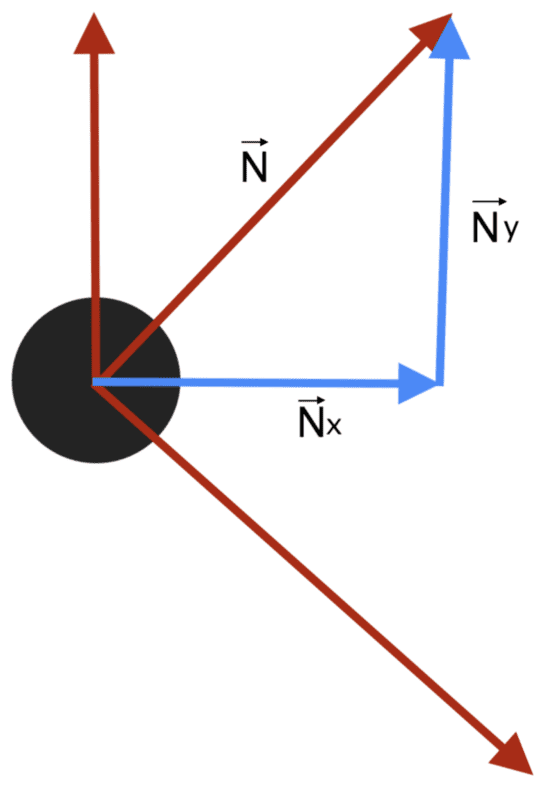

There are a few details, either convention or understanding, that I was hoping someone could help to clarify. Consider the object below, acted upon by a few forces including an unknown ##\vec{N}##, which I have split into its horizontal and vertical components ##\vec{N_{x}}## and ##\vec{N_{y}}##. Suppose also that ##\vec{N}## is at an acute angle ##\theta## to the horizontal.
Geometry dictates that the magnitude of ##\vec{N_{y}}## is ##|\vec{N}|\sin{\theta}##, and since it points in the defined positive ##y## direction we obtain ##\vec{N_{y}} = (|\vec{N}|\sin{\theta})\vec{j}##. However, it is quite possible that if we were to solve the system by applying ##\vec{F} = m\vec{a}## horizontally and vertically, the vertical component of this normal force might come out to be negative. However, ##|\vec{N}|\sin{\theta}## can't be negative, so what gives?
My suspicion is that the problem has something to do with using ##|\vec{N}|## in the components of ##\vec{N_{x}}## and ##\vec{N_{y}}##, but can't think of a reason as to why.
Likes JD_PM
If ##\theta## is a negative angle (i.e. an angle in the fourth quadrant) then its sine is negative.
And indeed, if the y component is negative, an accurate drawing would show ##\vec{N}## in the fourth quadrant.
It is very often convenient to use signed angles in this manner.

I see what you mean in this scenario, however suppose instead we have a system of of two particles which initially had a total momentum vector ##\vec{p_{1}}##, then collided, and now have velocities ##\vec{v_{1}}## and ##\vec{v_{2}}##. If we have no other information, we might draw both velocity vectors to the right so that e.g. ##\vec{v_{1}} = |\vec{v_{1}}|\vec{i}##. Of course this is incomplete, since we might also have ##\vec{v_{1}} = -|\vec{v_{1}}|\vec{i}##. However we have no way of knowing which is correct. What can we use in this case?
Or, if we altered the first situation slightly so that ##\vec{N}## points vertically upward, we would have ##\vec{N_{y}} = |\vec{N}|\vec{j}##. This appears equally problematic.
I do not see any advantage to insisting on non-negative scalars in this situation. Pick a sign convention and use signed scalars. Just write ##\vec{v_1}=v_{1\text{x}}\ \hat{i}+v_{1\text{y}}\ \hat{j}## and do not insist that ##v_{1\text{x}}## and ##v_{1\text{y}}## be non-negative.
There is no need to shift from one coordinate basis for vectors pointing to the northeast and a different coordinate basis for vectors pointing to the southwest. Use one coordinate system and save yourself the headache.
Note that the relevant definition of scalar does not require that they be positive. They are elements of an arbitrary field. [For typical purposes, they just have to be real numbers]
I'd say your construction implies that ##\vec N## and ##\vec n## are parallel, not anti-parallel. Otherwise you'd have to allow for the possibility that ##N=−|\vec N|##. If you don't know which way something is pointing you have to allow for the possibility that your chosen arrow is pointing the wrong way, and hence allow negative multipliers.

etotheipi said:
This is sort of what I was thinking, however I am getting a bit muddled with the actual interpretation of these quantities.
For instance, if we return to the first scenario but make ##\vec{N}## point directly upward, suppose ##N## is the component (positive or negative) of ##\vec{N}## along the direction of the force arrow we have drawn (represented by unit vector ##\vec{n}##; this gives ##\vec{N} = N\vec{n}##.
Using lower case n for the unit vector does not seem like a very good choice here. It invites confusion.
Let us use unit vector ##\hat{j}##. We decide that ##\vec{N}## just happens to line up so that it is parallel (or anti-parallel) with ##\hat{j}##.
Now we want to be able to express ##\vec{N}## in coordinate notation, ##(N_x,N_y)## so that ##\vec{N}=N_x \hat i + N_y \hat j##. We know that ##N_x## = 0. We just want to be figure out what to put in for ##N_y##.
Simple: If ##\vec{N}## points upward (in the same direction as ##\hat j##) then ##N_y## will be positive. If ##\vec{N}## points downward then ##N_y## will be negative.
There is no need to insist that ##N_y## has to be positive because of some imagined rule that "scalars are never negative". Magnitudes are never negative. Scalars can be.
Individual coordinate values are scalars, not magnitudes.
Right, so essentially whenever a vector has unknown parts it is best to define a new scalar component and work with that?
Sure. You split the vector into components, write down an equation and solve for the value of the unknown component. The solution may come out positive or negative. In which case that coordinate will be positive or negative using the chosen coordinate system.
You choose the coordinate system when you split the vector into components. That includes specifying a sign convention. (right = positive, up = positive, etc).
